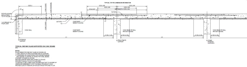

There's a project ongoing that requires some very tight reinforcing steel placement.
How would you specify concrete for this job? Is this too tight for even Agilia to flow through?
Why could they not have used larger steel with more reasonable spacing?
 https://files.engineering.com/getfile.aspx?folder=de82b8a3-e81a-4a09-9036-899d347b4bf6&file=Document2.bmp
SuperP with sand?
This IS a job that would definitely require Independent Review of Structural Design as per EGBC.
Hard work for the craft?
Wouldn't the craft know that if you can't get a pen between the bars then they won't be able to consolidate the concrete?
EGBC? Engineers and Geoscientists of British Columbia?
So far this looks like a construability issue at the intersections, so I am not sure the independent review would have flagged that unless it was an old dog that was keen. I suspect someone like Harris Rebar detailed, supplied and installed the rebar. They usually flag this type of problem and I would not be shocked if the shop dwg review process missed the problems. The usefulness of shop dwg reviews has really went to the dogs over the years.
