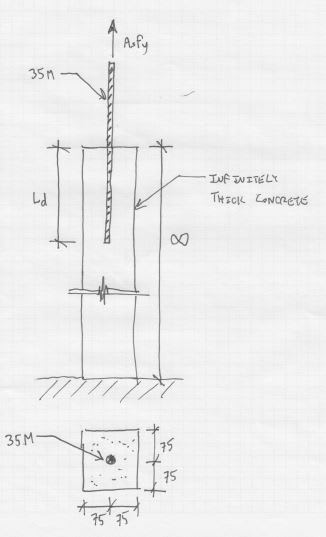

As many on this forum know, there are a couple of previous threads that address the debate of anchorage vs development length for rebar that KootK has done a great job of spearheading. Here are a few of them:
thread507-401855
thread507-379988
What I didn't know is that ACI 318-19 now addresses this to a certain extent, I don't think this has been noted here before (I didn't find anything in a quick search) so I thought I would share.

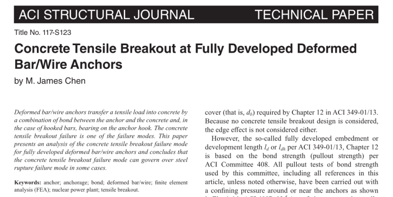

Yes!!! Hell yes!! And I've been waiting for vindication on this for the better part of a decade now given that most of those threads tended to have a "KootK vs The World" character to them. Celt83 also turned me on to the 2020 paper below which basically supports the same conclusions. One of the sketches in that paper looks so very identical to the "ridiculous" sketch that I posted here back in 2015 that I almost wonder if researchers don't troll this forum for good research ideas.
Suck it world!! Sorry, couldn't resist...

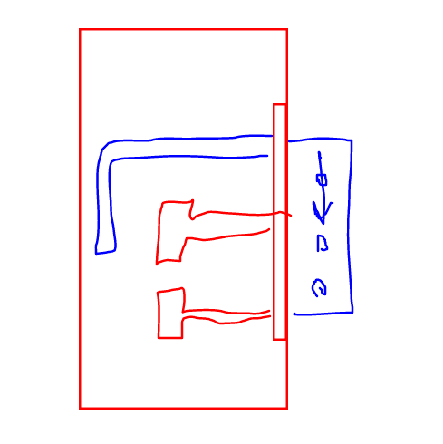

It will be interesting to see how this plays out for connections like that shown below which are common in a lot of applications, including the nuclear, precast, and tilt-up worlds. I would think that the range of application for the deformed anchors in such spaces would diminish significantly given that:
a) One can no longer use such anchors to obviate the need for tension breakout checks and;
b) We don't really have provisions allowing us to assess groups of anchors containing different types of anchors.
In most applications like that shown below, I suspect that the deformed bar anchors will just get replaced with more studs even if, in reality, that produces a weaker connection. It may wind up being a bit like the current situation with through bolting: we all like it, but we don't really know what to do with it calculation-wise. At least I don't.
