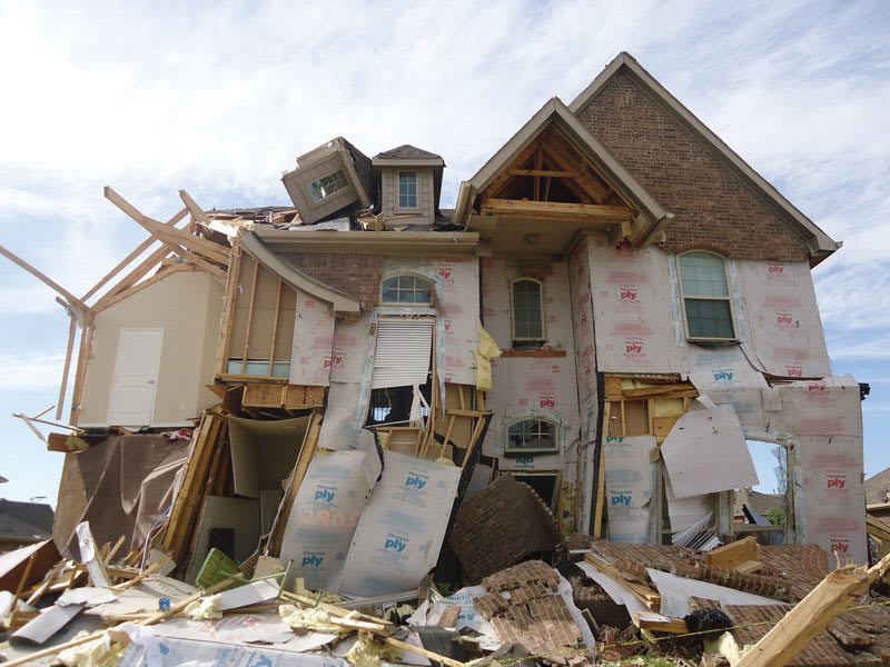

So I was out walking a job site a while back and noticed Thermo-ply in lieu of actual WSP - an engineer we were with pointed out that the APA said some thermo ply homes may be under designed for lateral loads by as much as 39 percent. That kind of makes complete sense when you hold the stuff in your hands - you can tear it apart with your bare hands, try doing that with wood sheathing!! I understand that a weird composite material might have the tension strength much stiffer materials have but it's apparent just by playing with it that the compressive strength is absolutely awful, which is what the APA test in their product advisory seemed to indicate too. The stuff in compression might as well be cardboard, and part of a racking load on a set of studs is most certainly compression right?
Given the data out there about it being so dreadfully worse than plywood/osb per length, and the fact that I have not seen any further testing of it to refute the APA's claims (other than claims from like Ox itself claiming the APA is biased and/or they didn't like aspects of the test, even though they didn't bother to reproduce them...) I am left wondering, why does the IRC still allow it to be used equivalently to WSP/CS-WSP!?
This is on top of the fact that we all know the proper nailing patterns are often not being followed anyways and probably slip past inspection. I am SO curious if I'm the only one who finds the whole thing sketchy or if the industry as a whole kind of agrees and recognizes it as an issue. Is the problem that everyone is afraid to put out a negative opinion of Dr. J as an accredited lab? Every other product I have seen and or tested which is accredited by them is the same way - seemingly way overstated claims about products who similar manufacturers make, and those other manufacturers always have more conservative claims.

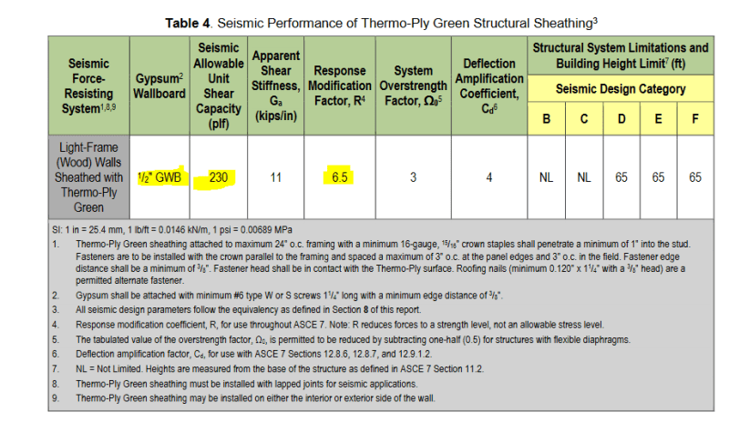

To add, taking a look at their research report 1004-03, it doesn't pass the 30k foot sniff test. They make rather bold claims in tables 3 and 4. Table 3 shows Thermo-Ply green without gypsum wallboard has an ASD design wind capacity of 190plf for 24" o.c. studs (what is the stud Specific Gravity value?).
Table 4 indicates seismic performance, and shows Thermo-Ply green with a seismic capacity of 230plf. Why is the seismic performance 21% higher than wind performance, that's counter-intuitive to how wood structural panels behave. On Table 4, they indicate 1/2" gypsum as part of the assembly, but also indicate an R factor of 6.5, which does not apply to gypsum wallboard shear walls (gypsum shear wall requires an R of 2 per ASCE 7-16 Table 12.2-1, which will dramatically increase design lateral loads on the structure). So they are claiming either a)their panels outperform for seismic load when compared to wind load or b)they are including contribution of interior drywall for capacities, but publishing an incorrect seismic response factor.

I've seen it used as roof sheathing at least once, and as I recall it had tile on it. Apartment. I made a point of discussing it in my report and suggested it be replaced.

I have no experience with this product and just took a quick look at their wind/seismic report for the blue (highest strength) product. The in-plane shear numbers are hard to believe for what's essentially a 1/8" thick wood product stapled to wall studs. I also noticed that the panel's strength to resist out-of-plane wind loads is dependent on the installation of interior drywall, which seems questionable.

I may be wrong, but based on my skim of the report and previous encounter with it in the field, (as roof sheathing, mind you) the wall version of this (which it's actually uh, listed for, as a braced wall replacement?), depends at least partly on the interior gypsum board. It seems this is a "combined" assembly. Without trying to impugn the material, it appears it's a mix of something approaching fiberboard, and the outside surfaces have plastic adhered to them.
