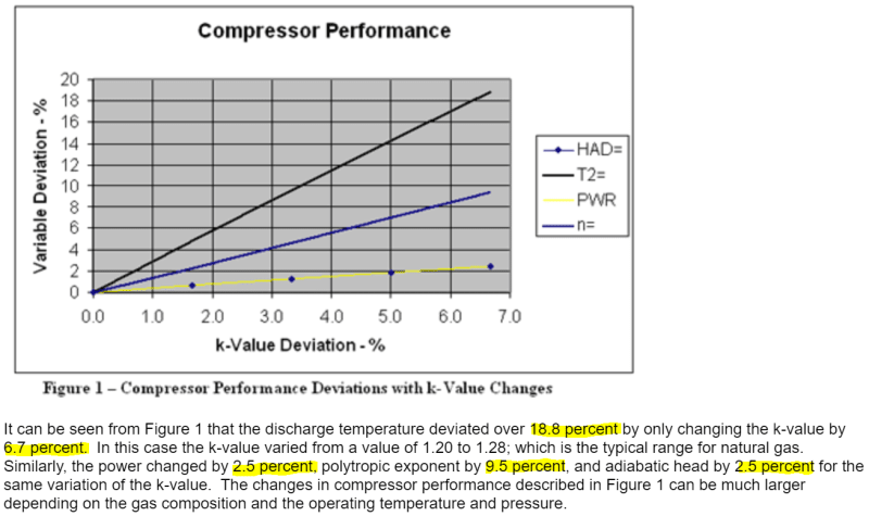

The importance of a correct K/gamma-value for you inlet gas when selecting a compressor is of the utmost importance as you can read here

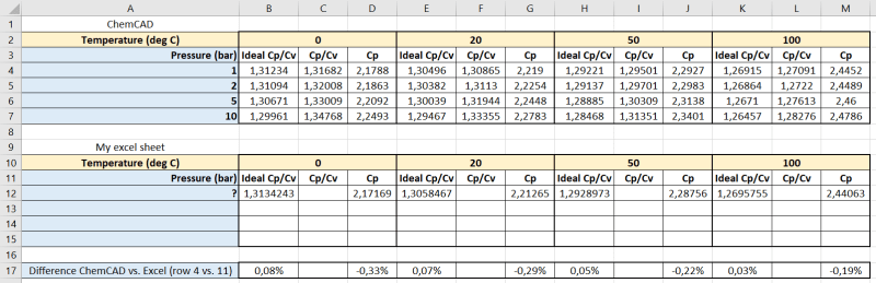

I made this comparison of Methane between ChemCAD and my excel sheet:
The difference between ChemCAD and Excel now is very small, the biggest discrepancy is 0,29% as you can see.
If we consider that this is the gas composition on compressor suction side, I think this is reliable enough considering that 99% of all past projects has a compressor inlet temperature between 0 to 60 deg C and pressure between 0 and 3 barg.
As you can see above, ChemCAD provide Ideal Cp/Cv and just Cp/Cv which I assume is the "real Cp/Cv" that you refer to. However, when I notice the minor difference between them, it seems like it might not be worth the effort.
Cp and Cv is only interesting for me in order to determine the K value as correct as possible. Since deviations in the K value has a big effect of several compressor performance parameters:
What do you think, is my current method reliable enough to calculate the K-value which will feed my compressor performance calculation? Can you see a scenario where the K value of a suction gas mixture at temp. 0 to 60 deg C / 0 to 3 barg using this method will always be within a few percent of reality? Or to increase the stakes a bit, if you were the buyer of the compressor and you knew that the K value was calculated this way instead of using a trusted source like HYSYS, would you have confidence in that the result is good enough to be the basis of the compressor performance?

Pls note that the semi ideal Cp/Cv approximation to k gives some acceptably reasonable values for compressor power only for many gas streams, but not for discharge temp. Process simulators use the real k value (isentropic exponent) to estimate discharge temp.
@hirschaplin
for info
pierreick said:
You should acknowledge that Cp is a function of T and P. For ideal gas, cp is only a function of T.
source: Energy Institute "Guidelines for the Avoidance of Vibration Induced Fatigue Failure Process Pipework" 2008
 https://files.engineering.com/getfile.aspx?folder=6de9298f-500c-41c0-bfe2-32fa8b5f0ecc&file=Specific_heat_ratio.png
