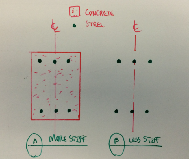

Hello Everyone. I would like to hear your ideas about doubly reinforced beams that has equal amount of reinforcement in compression and in tension. Is that ideal or no?

Of course we do. I was asking for some deatail and justification for your 2 x (ST stiffness w/o tension stiffening) shortcut as a reasonable upper bound estimate. Does it show up in print somewhere? Is there a graphical relationship that can be pointed to? Does it have a physical meaning that one might be find intuitive? Is it an extension of old school code recommendations like the 6X algorithm? Or do I just have to be smart enough to infer it from first principles somehow?
How come conservatively ignoring tension stiffening, and conservatively allowing for creep and shrinkage by multiplying by 2, needs detailed justification, but conservatively ignoring the concrete altogether can be accepted with no justification at all?
Anyway, the justification is years of comparing results with more detailed calculations, and measured deflections (both research and on real projects).
That said, having checked the steel only results with my approximation and rapt's, they all give about the same order of conservatism. The steel only approach has more variation than the others, but not by as much as I expected.
Like all things, it does require justification. I assumed that the justification was so abundantly self evident that elaborating upon it would risk insulting folks. See justifying sketch below. Try not to be insulted.
You realize that I can't see these things from here, right? I'm happy to take you at your word but, in practice, it's weird for me to use your experience as my justification.

Love this. Star for effort. It's interesting to see that the steel only method is as accurate as any of the other approximations for heavily reinforced sections as it is normally heavily, doubly reinforced members where folks will apply the method.
I'm curious if anyone has any thoughts on how far above the neutral axis the compression reinforcement needs to be to be effective for reducing long term deflections?
In the past I'm sure we've all been guilty of saying that the reinforcement at the top of the beam contributes, But probably never checked it as a doubly reinforced section to find out if the compression reinforcement is really effective to take up the concrete stress under creep.
Any thoughts while everyone is on the subject?

@IDS/rapt: I believe that there is a fundamental logical error in your thinking here that has yet to be acknowledged. You initially came down hard on my suggested approximation because:
1) You had simplified methods as simple as mine.
2) Your methods could do what mine does.
3) Your methods would be more accurate.
I submit that #2 is false. Precisely because of it's conservatism, I believe that my method could serve as a final deflection check whereas your methods, by your own admission (and my concurrence), would only be suitable for ballpark estimates that would need to be later validated more detailed calculations.
So I do not believe it valid to present your rough estimatation methods as being superior to mine in all respects. There is an apples to oranges dimension to this.
