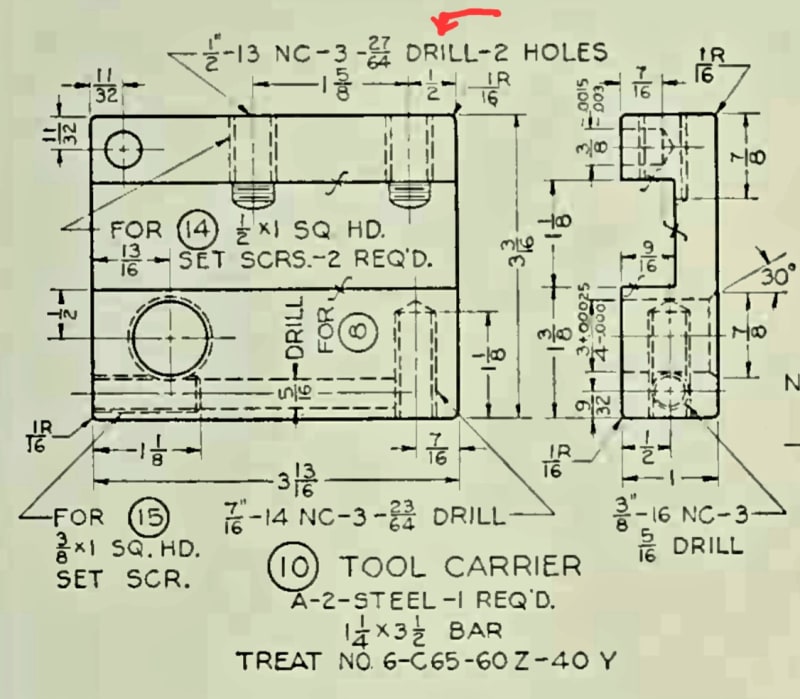

Is the term 'Drill' still used and if it is doesn't Drill have it's own tolerance depending on drill size?
If you're asking about using that term as a specification on a drawing, the answer is that it's usually discouraged. According to the ASME Y14.5 standard:
"The drawing should define a part without specifying manufacturing methods. Thus, only the diameter of a hole is given without indicating whether it is to be drilled, reamed, punched, or made by another operation. However, in those instances where manufacturing, processing, quality assurance, or environmental information is essential to the definition of engineering requirements, the information shall be specified on the drawing or in a document referenced on the drawing."
That's paragraph 4.1(e) of the 2018 edition.

Hi, ozzy1:
As a designer, you need to define what you need rather than how to get it. Leave that to your machinist and your process engineers.

ozzy1,
Is there a standard somewhere that specifies what the word "DRILL" means?
If you want a hole, specify a hole, with tolerances. Don't tell the fabricator how to make the hole.

I am QC not engineering. We have a couple of young engineers that are using 'Drill' and then put a +/-.002 tolerance. I thought Drill had been removed by ASME at some point, obviously not from your comments. I will have to impress upon them that if they want a hole give a diameter plus the tolerance.
Thanks guys.

ozzy1,
Your +0/-.002 tolerance is potentially fun. Drills make oversized holes. Machinists know this, and it is documented in the Machinery's handbook. They can do all sorts of jiggerypockey with pilot drills and such. All the more reason to now not say "DRILL" on the drawing.
JHG
The table in Machinery's handbook was from tests on iron, I think. If done properly one can get undersized holes in metals with large coefficients of expansion; one can even take a dia 0.250 bit and make a 0.125 hole in a rubber sheet. If diameter is important then don't depend on a drill bit.
"Drill" goes on a factory floor process sheet to tell the shop floor worker what to do, as the sample image above is for. That allows the correct allocation of planned time and resources. Otherwise you get workers as a QA buddy of mine discovered, RIP Hank, on the factory floor, using a reamer to make a hole because the drawing had a small tolerance. Not often, as he put it, does one see a reamer glowing dull red.
