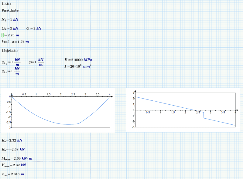

Hi
Im trying to calculate the bending moment and shear force depending on the distance x along the beam.
I tried making "a" into another matrix but then its either not a scalar or it says the number of rows and collums isnt the same.
I saw a similar problem on here but didnt quite understand the solution.
Please help.
Best regards
Mathias

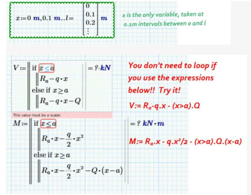

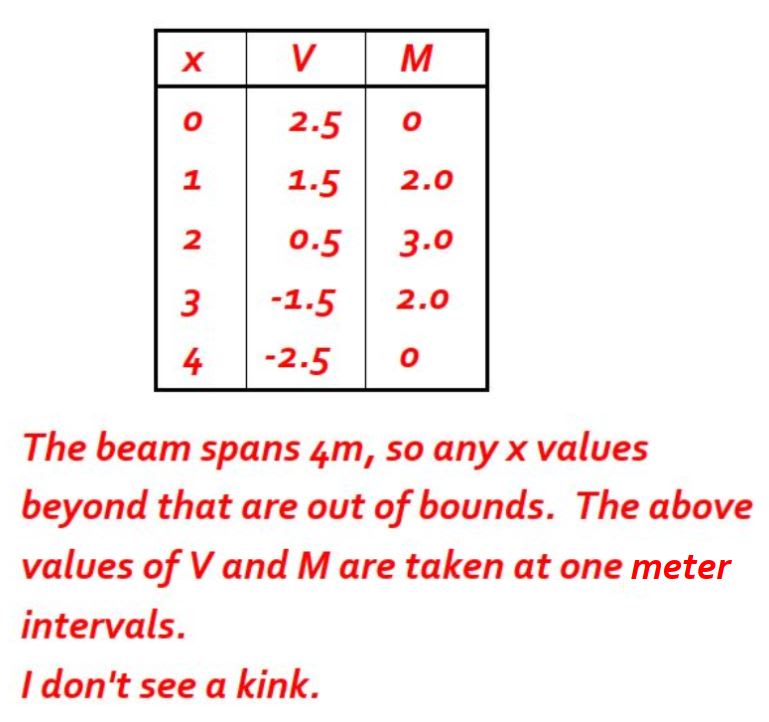

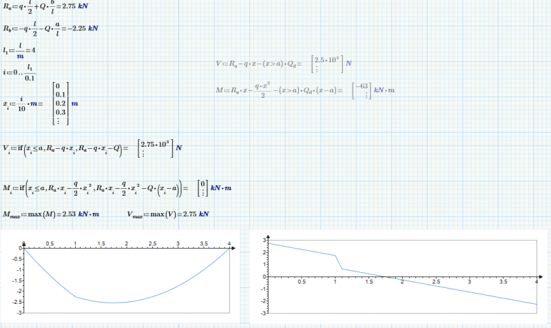

but the beam is only 4m long ... so xi>4 should "bail out"
you've defined xi as "i"m, this is shown by the first 5 results being "real"
I think the interval is 4 m, not 40 m. Use x1:=0.1*i*m
IRstuff said:
Yeah, I was going to do that, but got distracted. It's better, but it's still not smooth like it's supposed to be, but it's not my homework, so I'm done
Your diagrams look precisely as they should. There is a concentrated load of 1 kN at midspan, so the shear diagram has a sudden drop of 1 kN at midspan and the moment diagram has a slight cusp at midspan.
It may not be your homework, but I would give you 100%.
nah ... nothing over 90% ... that direct shear input should be vertical ... but the method doesn't lend itself to two points for the same x.
and should rise to 0 at the end (but that's being pedantic).

This inequality operator is only for scalars; x is not a scalar.
which is why "x subi" worked ... identifying a element within the x array
I have been treating x as a variable and a scalar. The OP seems to be doing the same. See below.
Is this in conflict with Mathcad Prime 9?
No, x is a 1 x m matrix, if you will. As with such constructions you can reference the entire matrix as in state matrix math A*x == I sort of things. There is no conflict. However, if you want to compare a single value with the matrix to a, you must use the indexing operator.

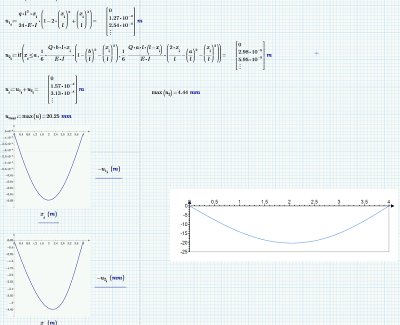

I wanted to learn to calculate the deflection equation the same way i did with SF and BM, so it also depends on the "xi", do you have an easy way to do this?
Yes, indeed! Use the principle of superposition. You have a uniform load and a concentrated load. If you know the deflection at any x due to each type of load, the combined deflection is the sum of the two. Just add 'em together.
you calculate deflections from the same loading diagrams ...
start with distributed loads,
integrate and add point loads from Shear Force diagram,
integrate and add point moments for the Bending moment diagram,
then integrate M/EI for slope along the beam (EI is typically constant but can be function of x, finally
integrate slope for deflection.
For simple loading (like point load at a or uniform distributed loads then are readily available solutions (try Roark or any text).
You may need to superimpose two separate loading to get your solution.
Hi
I tried the superposition principle, and it works great!
