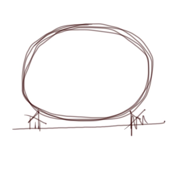

Excuse my really bad sketch... done on the phone screen... But is this what we’re talking about?

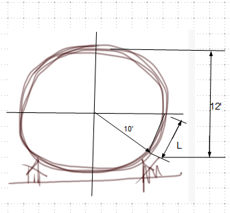

r13 - in that case, what are you suggesting would be the “L” length for the Euler calc?
mich said:
The height is around 12 feet.
Assuming the chord length is 25", as a rough estimate, the thickness of the plate should be about 1", so it will yield prior to buckle.
That looks like a really bad assumption, retired13.
BA
BA,
Maybe. Don't forget, this is only the starting point, not the final.
The assumption is simple - the half circle is stable when subjected to in-plane stresses. However, the lower leg is critical, as the angle getting smaller, beam/column behavior is getting more pronounced, and the chord length is getting closer to the arch length. The application of Euler equation with pin-pin support is conservative, and the thickness, that would satisfy yielding prior to buckling, can be worked out. If the actual load is low, the thickness can be reduced, but the critical buckling stress needs to be re-checked. If the load requires a thicker plate, then buckling strength should be met.

It's not even a starting point. The chord length to be considered should be closer to the distance between a support and the top of the circle.
