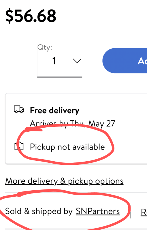

Especially when modern bearings use polyurea grease which I have never seen sold at an auto parts or DIY store.
The incompatibility of grease systems makes me long for oilers. No thickeners means nothing to harden and block the bearings. Even with compatible greases, oil loss still leaves thickener that is difficult to remove.
Tugboat - Gotta look in the farm department:
I just pointed out it's available from places people currently shop. Online stores count. It's not unfindable. It may be better that way as mixing greases is a great way for those with no background in lubrication to destroy equipment and grabbing a tube from the shelf will do that.
