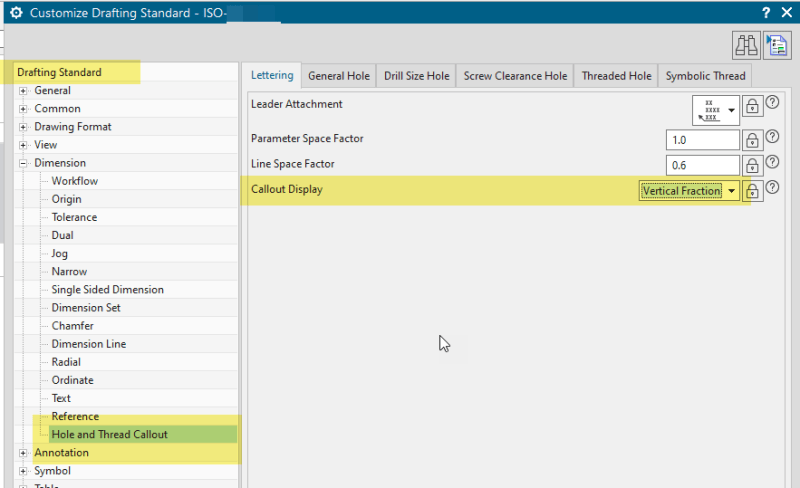

Hi
When the Thread hole callout is created by using "Hole and Thread Callout" the callout is showing fractions , We are unable to find the setting to change to Decimals as shown in the attached image. Can somebody advise on how to change to Decimals from Fractions.
 https://files.engineering.com/getfile.aspx?folder=45367844-ed5b-4cb0-b9ee-936da98406ff&file=RadialHoleThreadCallout.jpg
How about this ?
File-Utilities-Customer defaults -drafting- edit drafting standard
