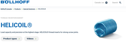

https://www.stanleyengineeredfastening.com/en/brands/Optia/heli-coil
Heli-Coil®​
The Heli-Coil® portfolio of wire threaded inserts includes offerings of a variety of configurations whether it be plating, material, locking, or non-locking variants that make it fully adaptable and configurable for industries spanning automotive, industrial, aerospace, and defense. There is a strong industry trend toward the lightweighting of materials, yet achieving structural integrity of bolted or fastened joints. Heli-Coil® by nature of its design is an ideal solution to be incorporated as part of these assemblies.
https://www.boellhoff.com/ca-en/products/special-fasteners/helicoil-thread-inserts-for-metals/

I would also try the insert.
Also, make sure the tapped threads are clean. I have seen too many threads with metal bits in them from the tapping process that will cause the bolt to strip or get stuck.
Direct threading into Aluminum is rarely a good idea. Baseline stainless steel threaded inserts.
Direct threading into aluminum is not a problem and is commonly done. There are issues only when multiple cycles of assembly/disassembly occur or extremely high torque is applied or the fastener is undersized to the loading. Inserts are used when a product or application supports the cost and/or the use profile requires maximum strength and highly reliable assembly/disassembly. Go take apart your car or motorcycle and count the number of inserts used in aluminum parts with threads. Certainly, this is probably different for an airplane or aerospace application or similar but the use case is different. Verify the threads were formed properly, the torque applied is correct for the material strength and the environment is not promoting corrosion.
