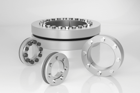

long tubular sleeve with shrink disk locking devices comes to mind -

Coupling or shrink disc cannot be added as the shaft goes through series of collars and bearings before it gets coupled to the gearbox.
