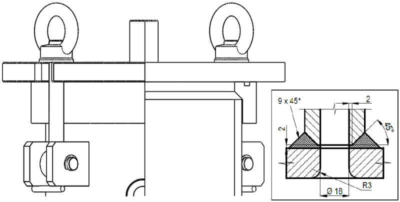

I have seen many posts on the forum about this topic, but I haven't found one that really answers this question.
I will try to be as clear as possible: I have a flat cover that I designed according to UG-34 for a filter, which serves as a manway to change filter elements. If I place a threaded coupling on this cover to function as the equipment vent (it will not have external loads), should it comply with the requirements in UG-45, or would it fall under the 'manway opening'? The idea is to install a 1/2" NPT Class 3000 coupling, but its thickness, while meeting the required thickness + CA and UG-16, does not reach the value in the UG-45 table + CA. It is mainly to understand if a connection placed in a manway is still exempt from what is required in UG-45 when there are no external loads.

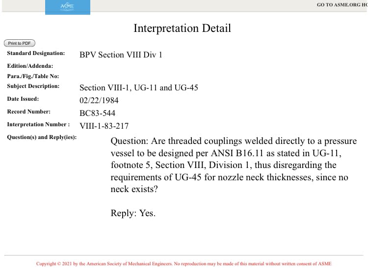

"Interpretation Number : VIII-1-83-217
Question: Are threaded couplings welded directly to a pressure vessel to be designed per ANSI B16.11 as stated in UG-11, footnote 5, Section VIII, Division 1, thus disregarding the requirements of UG-45 for nozzle neck thicknesses, since no neck exists?
Reply: Yes."

I've seen that clarification before, but I don't quite understand it. Could you explain to me what it means? I understand it as follows, "the standard thickness of the Class 3000 threaded coupling verified for internal pressure is already sufficient, and UG-45 does not apply." Or is there another calculation method in ANSI B16.11?
Both refer to Ansi B16.11. What is the thickness requirement for threaded couplings according to that?

What is visible is the manway of the filter with the threaded coupling 1/2"NPT welded on the flat cover. The vessel is manufactured with a seamless pipe NPS 8"
I want to see if I understand correctly everything you have been telling me: According to ANSI B16.11, the 1/2" Class 3000 threaded coupling is equivalent to a 1/2" (DN 15) Sch 160 pipe. If I use that thickness and subtract the manufacturing tolerance of 12.5%, do I only need to verify it for internal pressure according to UG-27, and it wouldn't be necessary to comply with UG-45? (Even though I still believe that being in the manway excludes it from the verification)

OP,
Are we not talking about 'Opening in Flat Heads and Cover'? Why are we even looking at UG-45?
You have designed the flat head per UG-34. That's absolutely fine. Now if you want to do an opening (vent), simply apply the rules of UG-39, for opening in Flat Heads and Covers.
Why do you want to use UG-45, which is rule for 'Nozzle Neck Thickness'?
ASME B16.11 fittings are acceptable to the Div 1. Make sure that you pick up the correct pressure rating for an equivalent seamless pipe with maximum allowable stress value for the coupling material chosen and the thickness tolerance for the ASME Standard.
You might have to play a bit on the rating to also comply to UG-39 rule on reinforcement area requirement.

Is this wrong? Or am I misinterpreting it?
GD2,
What do you understand from that interpretation?
(Even when it comes to a manway, they must comply with UG-45, but the formula is different (t_UG-45 = t_a). I'm not saying that compliance is unnecessary; I'm saying that the criteria are different from a common connection)
