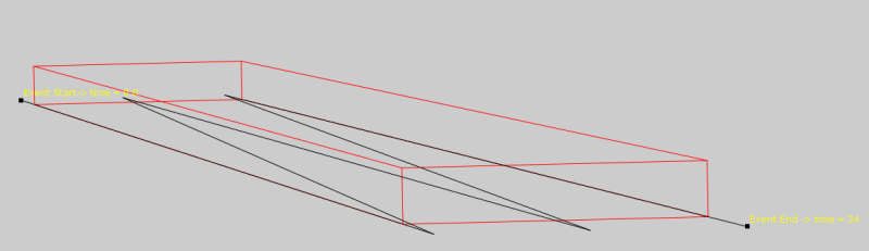

This is your toolpath for this build part, right ?
First thing is that it has to be denser but I assume that it's only for testing. But more importantly, I think that you should raise this path a bit (in the direction of build part's thickness) so that it's not aligned with the bottom surface of the part. Or add next pass of the nozzle right above this one. That should be done to make sure that the tool will intersect with all elements meant for activation during given pass.
Also check the bead settings and make sure that they are correct.
This is correct for the toolpath build part. Do you mean that the mesh for the deposition has to be denser? Brilliant thank you very much for that advice and I shall work on that. Would you recommend making the built part mesh more dense than already? Comprising of more elements? The bead settings have been set in meters also, I think the problem lies in placing the bead width too large, therefore the catchment isn't correctly aligning with the Goldak radius.
I shall try these and get back to you. You have been great!!
No, I meant the toolpath - it should be denser (more passes for this layer). The mesh seems good. But raising the path a bit is the first thing that should be done.
