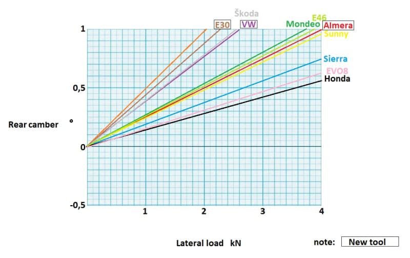

With my tool i know loaded contact patch quite accurate and repetable,deflection read at rim against body movement
on Video is not my car , is BMW E30 my friend car (almost stock setup)
noticable bearing deflection, found arm and crossmember significant bending(camber loss and toe-out under loading)

on my car is fully adjustable ARB blade style...............this BMW suffers sudden oversteer
Greg
this BMW have +0,5Dg/kN camber and -0,1Dg/kN toe loss
now after arm and crossmember reinorcement +0,3 camber and -0,05 toe
my car (Ford Sierra) currently +0,2 camber and -0,015 toe
some cars rear camber lateral stiffness
new tool = load to contact patch, old tool=load to wheelcenter
