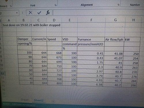

Plz see test we have done with various opening of the ID fan damper.
Is it normal that the current remains fixed at 644 A? Should the current not vary proportional as the kW varies.
SA07,
Finally some decent data!
I return to my point some months ago - Based on the curves you supplied, the shaft power required by the fan at the lower speeds should be about 150kw.
41 tonnes per hour at 190C is 55,000 m3/hr.
Using your graph this equates on the X axis to 7.5 (x 7310)
At less than 815 rpm this should therefore be 1bout 150kW, yet your system claims over 250. So there is a very large gap between what the fan supposedly needs for the flow at that speed and what the motor is consuming.
So find the missing power.
Where / how are you measuring power? Is this electrical power into the VFD? or into the motor? VFD losses can be high, but not usually that high

Your VFD is being told to run at 100% speed, but it must also have a current limit programmed. The current limit works by reducing/limiting the rpm so the current doesn't go over the setting. In other words, the VFD is trying to accelerate to 100% speed but it stops at 668rpm because that's the rpm where it hit the current limit.
As for the fan data, hopefully someone else has some insight because its not making a lot of sense to me.
I see LittleInch has already commented. Double check the basic motor settings in the VFD. Also check the base or knee frequency, this is the frequency the VFD reaches rated output voltage and sets the V/Hz ratio.
kW is the power displayed on the VSD screen.
