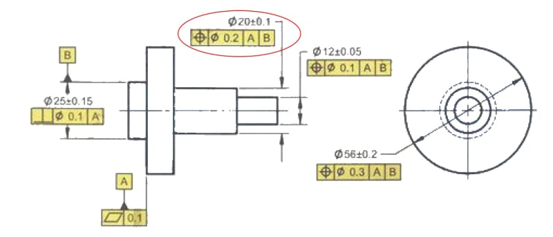

This came up on one of the drawings recently but I see it all the time, even in the textbooks. Say you have one circular feature with a perpendicularity constraint to a datum defined by a flat face and then you have another circular feature coaxial with the first one and having true position defined for it. For example Ø20 below
It is using two datums and establishes coaxiality to datum B and perpendicularity to datum A. My issue with that is that, the way I see it, using datum A doesn't add any additional constrain to the drawing. It defines exactly the same cylindrical tolerance zone around datum B axis, which is already perpendicular to the datum A. In other words, removing datum A from the feature control frame for that dimension will not affect the feature's tolerance zone at all... or am I missing something?
Referencing |A|B| or |B| is different and will result in two different inspection set-ups and different acceptable variations.
In the A, B scenario, the tolerance zone is centered to a datum axis (B) which is exactly perpendicular to datum A, which is derived from a datum feature simulator that makes full face contact with the actual datum feature A. Therefore the relationship between datum axis B and the actual datum feature B is not as tight as in the other case - the simulator of datum B is constrained to A and will not be the smallest cylinder that can contain datum feature B, but the smallest cylinder that can contain datum feature B AND remain exactly perpendicular to datum A.
If actual datum features A and B were perfect and exactly perpendicular, this wouldn't matter, but we know they can't be.
If the function of the part is such that datum feature A is forced to make full face contact with the mating part, then |A|B| represents the assembly conditions better than just |B| and it is preferable.

Let me illustrate:
Here is the case when both datums are used:

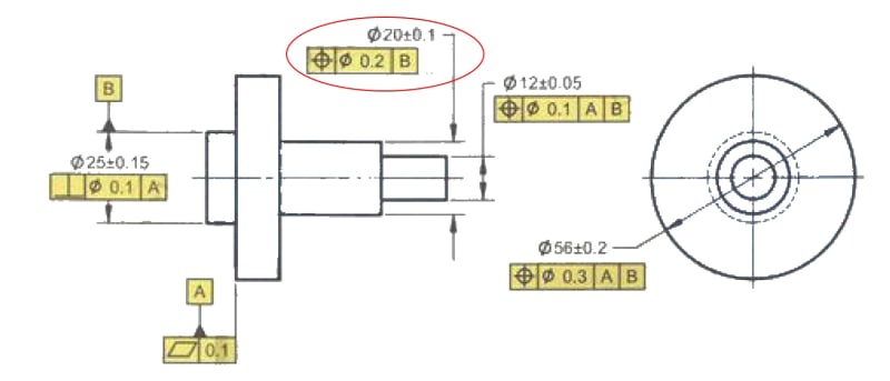

Here is the case when only Datum B is used
So, if the tolerance zone is the same in both cases you end up with a feature that has the same orientation and location constraints and it requires less effort to inspect it in the case when you specify only datum B

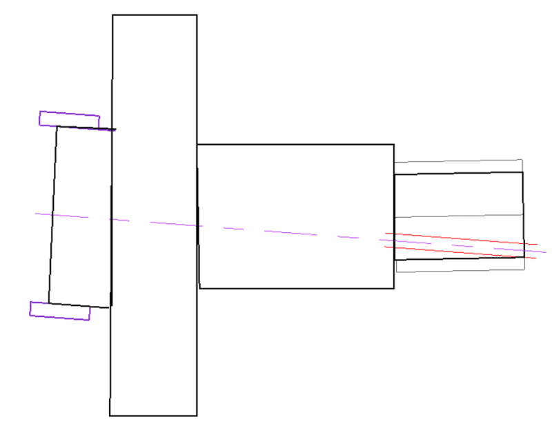

In the case where only Datum B is used, the B simulator needs to be aligned to the axis of datum feature B. In other words, simulator B needs to be the unrelated AME of B. Your drawing has it aligned perpendicular to A.

Example two (feature with the Ø20 references only datum B):

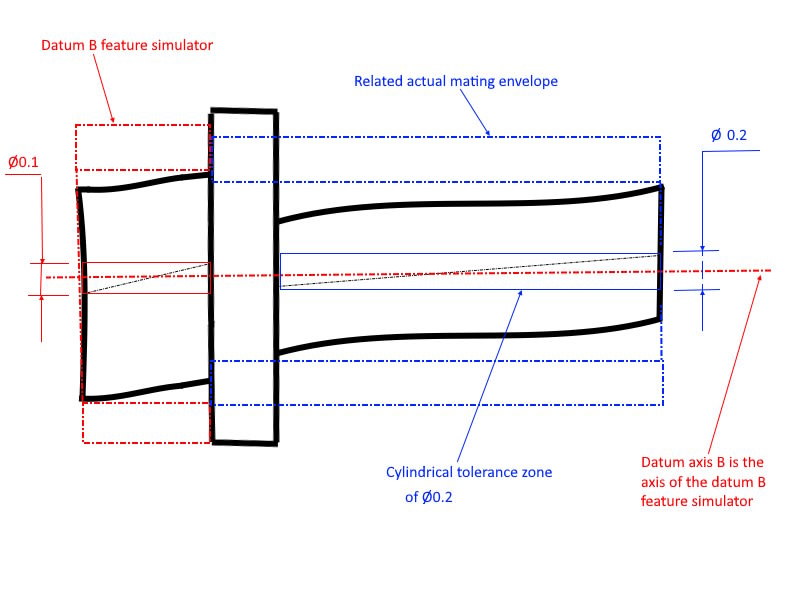

I'll try to address the original question. The tolerance zone is the same - it's a 0.2 diameter cylinder that is coaxial with datum axis B. What changes is the actual part's relationship to datum axis B, and hence the toleranced feature's relationship with the tolerance zone.
We're getting hung up on the details because the details are important. However, it can be difficult to get the point across in words - pictures are usually necessary. Your diagrams are great, but they show that there are a couple of details that you're not seeing correctly. Here is what it should look like when only datum B is referenced:
If we look at this, Burunduk's and greenimi's statements should make sense. Hope that helps.

Datum axis B is the axis of the unrelated AME if only datum feature B is referenced, and it is the axis of the related AME (perpendicular to datum A) if datum features A primary, B secondary are referenced.
Diametrix said:
Again, Datum B doesn't change from one example to the next, and it remains perpendicular to datum A.
Again, it is perpendicular to datum A only when datum feature B is referenced secondary after A. If B is the only one referenced, it is considered primary and the datum axis is the axis of the smallest cylinder that circumscribes datum feature B without any constraints (the unrelated actual mating envelope).
Regarding the tolerance zone:
You got one thing right, the tolerance zone is always centered to datum axis B.
But as Evan pointed out, the orientation of the PART changes relative to the datum axis and the tolerance zone from case to case. I attempted to explain that in my first response in this thread. So if you paid attention, this actually could be the answer to your main question.
Check Evan's illustration. It captures the meaning of the |B| case quite well.

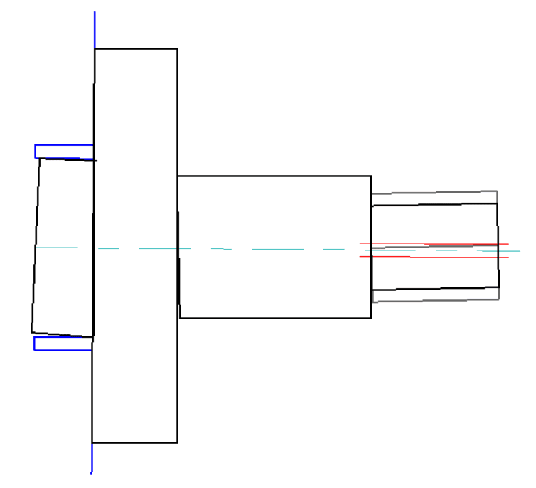

FWIW, here's the alignment for the A|B reference on the same as-produced part geometry.
This time, datum axis B is derived from a related AME (that is exactly perpendicular to datum plane A). The axis for the feature controlled by the position tolerance is the unrelated AME.
