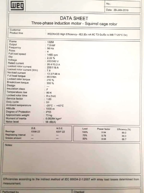

Hi everybody
No-load & full-load currents of a new motor are too high. What can be the reason?
Motor is: 7.5kW, 50Hz, 4 pole, full load current as per nameplate is 15A, but it is actually 24A. Measured no-load current is 10A. Motor is new. I have checked the terminal box and certainly the power cable is connected correctly.
What may be wrong?

One thing to add: six leads of the stator wires are accessible. So it is possible to verify wirings (star / delta). It is connected in star mode. If I connect it in delta mode, certainly the current will increase.
Keith Cress
kcress -
The rated no-load current is already 50% of the load current, so 10 A at a higher voltage is not surprising.
What is surprising however is that such a detailed nameplate did not mention the motor connection anywhere.
