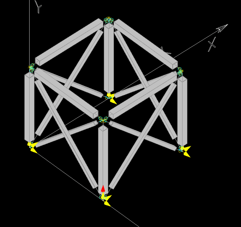

Do all 5 sides (4 sides and top) of a structure need to be braced if all connections are pinned and the supports at the base are pinned connections?
Here is an example to illustrate my question:
Would you say that the bracings colored in pink are necessary if all the connections are pinned? There are vertical loads (Y) and also wind loads in two directions (X and Z).
Without top bracings:
With top bracings:
That could be the source of the instability though, error in support input in the model.
If you can imagine a horizontal load on opposite top corners... it will want to do a parallelogram. Cross-bracing can be replaced with a single diagonal brace in tension or compression. Not certain, but I think all four corners have to be pinned to prevent a 'parallelogram' shape (pinned opposite corners would likely prevent that).

I agree with Tomfh. As a theoretical model, not only are the braces in pink unnecessary, but only one diagonal brace on each side is necessary for stability.
As a real structure, with connections and members that have limited stiffness and strength, the necessity or advantage of adding additional members to resist the applied loads depends on the connection and member stiffnesses and strengths.

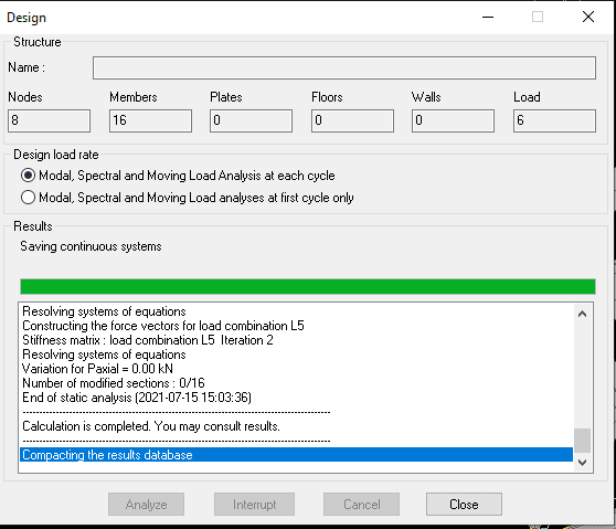

I just got my hands on the model again. You were right that the bracings are not necessary. The problem was that the column torsion at the supports was free. I fixed the torsion at the supports and now it works:
Thank you for your help!
