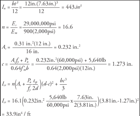

Below is a calculation on Icr for masonry. Maybe it is an over simplification, also the different material, but I think the concept is the same - increase in tension steel leads to increased Icr, which relates to deflection (immediate and long term). Another important property has not yet addressed in long term behavior of reinforced concrete is relaxation of steel (more pronounced in prestressed concrete though).
