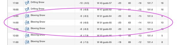

It is rather obvious, and there are many videos, that a crosswind gust picked up the left wing just at the moment of touchdown causing the right wing
to strike the ground and break off. If the landing looks hard and fast, it was to stay ahead of the gusts. Unfortunately fate interceded in this instance.
I find it disconcerting that the Fire Chief would claim there were no crosswinds at the time, and various news outlets would run with that. Toronto Pearson doesn't have a Runway 27 and all indications are strong gusty winds blew directly from the west for a good period of time during this incident. You can even see the wind driven snow blow diagonally across the tarmac in the evacuation videos.
From CBC
What was the weather like?
Todd Aitken, the GTAA's fire chief, told reporters on Monday night that the runway conditions were dry and there were no crosswinds.
What the weather was really like!
weather.gc.ca

It is rather obvious, and there are many videos, that a crosswind gust picked up the left wing just at the moment of touchdown causing the right wing/engine to strike the ground and break off. If the landing looks hard and fast, it was to stay ahead of the gusts. Unfortunately fate interceded in this instance.
From CBC
weather.gc.ca

Sym pe Le,
The crosswind was about 40 degrees to the runway (270 versus runway 22(0)) and may be a bit hard / on the limits, but the plane I think did a U turn / cartwheel so wind was actually coming in form the right.
Those planes have engines on the tail so the wing might be a bit lower to the ground than other types, but in such conditions I think they just got the flare wrong and flew it into the ground so hard the landing gear collapsed.
If those were mph or knots then it does look a bit too windy for that type of jet alright.

I agree. It's possible that with the hard and fast landing there was just enough roll with a wind gust to crush down the right gear first and collapse it. I'm starting to believe that the wind was more aligned with 27 than I first thought. The aircraft did not seem to have much crab to it either.
Its come to a stop at the junction of 22 and 15L see https://www.bbc.co.uk/news/articles/cm2dnnvvjkeo and turned back to face where it came from.
Also your wind speeds are possibly in km/hr if this is a canadian site?
