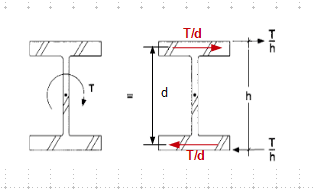

Hello:
I am designing a small frame with significant torsion applied to some members in RISA3D. After going through the help manual I have found that RISA does not account for any torsion in beams, besides torsion caused by frame racking (fixed end condition, point torques at ends), similar to what is found in case 2 of AISC DG9. Of course this means I cannot trust the results from RISA and I need to input my own torsional stresses, so I have set out to figure out how to do the hand calc.
I reviewed some threads here on the forum and see some users suggesting the "equivalent tee" or "bi-moment" method to conservatively approximate the shear and normal stresses from torsional warping as suggested in AISC DG 4.1.4. The DG provides the figure below and says the normal stresses can be found by treating each flange as a beam and using the following equation σw= Mf/Sf where; Sf= (tf*(bf)2)/6. I assume the flange in the figure below (fig 4.4) is showing the side view of the entire length of the beam.
So, to me this method seems extremely simple and if accurate and conservative I am happy to have found it, because it will take me only minutes to check my beam. I do have a couple questions though and as I am typing this I realize this post might even be more suited for the RISA sub.
1) Is this method accurate enough (conservative is probably a better word) and at what unity ratio from pure torsion should I opt for a more accurate calculation of torsion stresses i.e. if torsion capacity calculated per this simplified method is 50% of the beams flexural capacity, but the beam still passes code checks should I be worried?
2) If this method is so simple and seemingly well suited for an automated calculation, why in the world does RISA not support it as a simple check? The fact that they don't makes me feel like I'm missing something about the usefulness of this method
3) In this review I have looked more at how RISA combines torsion stresses in the interaction equation and it combines torsional warping stress with weak axis moment, which seems to contradict what DG9 is suggesting, since the torsional warping moment found in the equation above is a stress normal to the flanges, or a major axis moment. How can this discrepancy be explained?
**As a bonus question has anyone used a shell element model to study the effects of torsion on I-beams that can speak on the efficacy of that method? I have created an FEA model of my frame with shell elements, the beams are relatively short < 10 ft W21x76's and support a point torque of 48 kip*ft and won't be limited by LTB and I'm not aware of any other buckling modes I need to be aware of (pure torsional buckling in the web?). I have ran a linear-static model and show very favorable stress results, which I am trying to confirm with this hand calc and of course the original RISA results.**
This is the way I resolve torsion.
1) Is this method accurate enough (conservative is probably a better word)....
From everything I have read, the Flexural analogy is conservative.....the problem though is: in some cases it is excessively so. (There is a brief discussion on this in Salmon & Johnson's text on steel design.) For more accuracy, it is typically modified by a β value. (I've heard some people call this the "Beta Method".)
Of course with all the spreadsheets/programs with the differential equation solution programmed in.....all this is not necessary at this point.

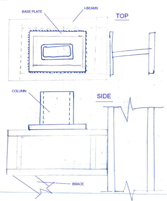

Just out of curiosity how long are your members and why are they receiving torsion. The reason why I ask is because most of the time if torsion on an open section beam matters then deflection will normally control well before strength.
The hand calc method you refer to (as far as I understand) is always conservative.
I don't think this is a contradiction. In your pictures, you're resolving the torsional load into equal and oppose weak axis load on the flanges of the beam. Right? If you apply those point loads to the WT only (assuming the W beam is split at the center of section) then this produces stresses in the top and bottom flanges that are akin to what you get with weak axis bending of the section. It's just that the stresses in the top and bottom flanges are headed in different direction.
it's quite a unique structure. The beams in question actually support a center mounted column and base plate. Torsion is transferred through the base plate through bearing and through welded connections at the edges of the plate. The beams are about 6' long. I developed an FEA model with plate elements for the deflection, but since I'm a relatively new FEA user I was worried about blindly trusting the Von Mises stress results, mainly in case I was missing a buckling failure mode like canwesteng pointed out.

@MegaStructures
Can you please upload an image of your FEM model so that I can comment, I do not want to prematurely say something not having all the facts at hand, as I am thinking of the situation as I would model it.
Depending on the extent of what you have modeled may also change the way loads are applied. If you just have the beam of concern modeled then you would need to apply the load at the weld as the loads the weld would see it. Thus you would need to get the distribution of loads on the weld (which is simply from basic hand calculations) and then apply that distribution on the beam at the location of the welds. Alternatively you can use links to distribute the loads as required.
I assume that the torsion is coming from the fact the the "column" has a moment that is transferring as torsion in the supporting beam?
If you can confirm the above I can make a better comment and also build a small model that I can share to show how I would do it.
