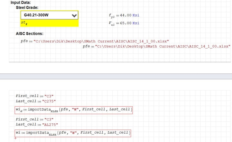

Having problem with the XLSX file input. This is the SMath

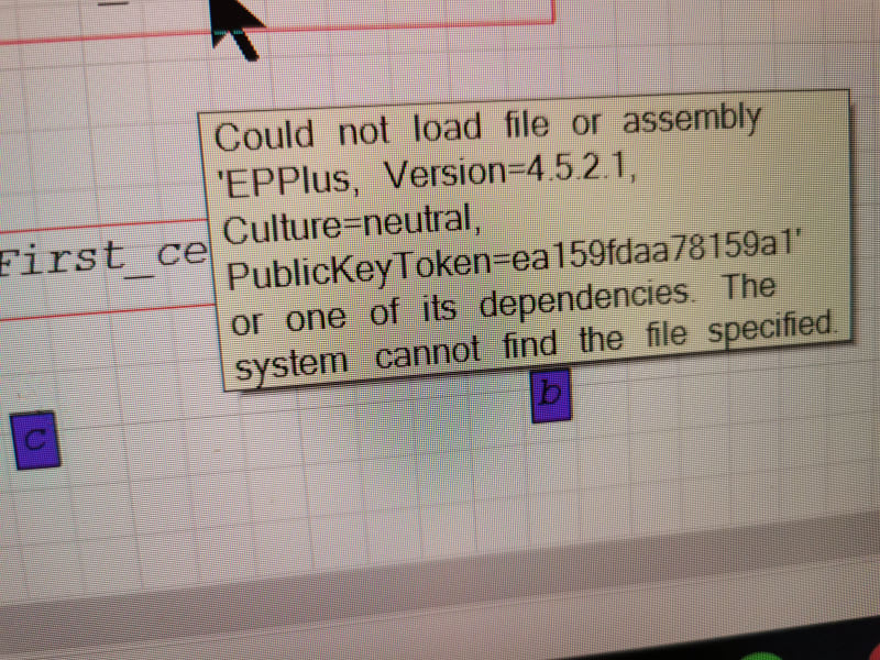

and this is the error message:
I'm using Libreoffice and not Word... could that be the issue? "pfe" is the path\filename.ext and it's correct. Any suggestions? Dropdown list works well.
Hey Dik. I'm not sure. I haven't seen that issue before. Could be related to Libreoffice as opposed to excel.
I actually don't use this function often. I think it just takes too long to load things in every time. Typically, I use it once to get values in a matrix and then just copy that matrix and keep the values in the SMath file. Obviously, this does nothing for you at the moment (sorry), but I'm sure you would have better luck on the SMath Forum.

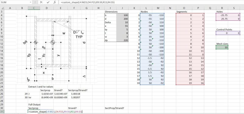

Returning to the original topic:
I have added an Excel front end to the Python section properties program linked by Celt83:
I have compared the results with output from the Strand7 FEA package and found close agreement.
The spreadsheet and python file are attached. Note that:
1. The spreadsheet requires the Python SectionProperties (+ meshpy, numpy, etc) to be installed and also pyxll (which is a commercial program)
2. The SectionProperties installation via pip didn't work for me (in Windows), but I found if I copied the sectionproperties folder into my active pyxll code folder, the code worked, other than plotting.
3. I haven't been able to get the plotting routines to work with Excel, in fact they usually cause a crash, so all calls to plot routines in the example functions have been commented out. The custom_shape function will however return all 64 section property values as a dynamic array.

Thanks Doug... I've used my approximations; they're not critical, and have issued the drawing. I was looking for an easy methodology so I could incorporate it into my SMath programs. I've compared the calculated values with outputs from a 'real' program that generates section properties and am within about 30% on the low side.
Again, thanks very much; your input as well as the others is appreciated.
