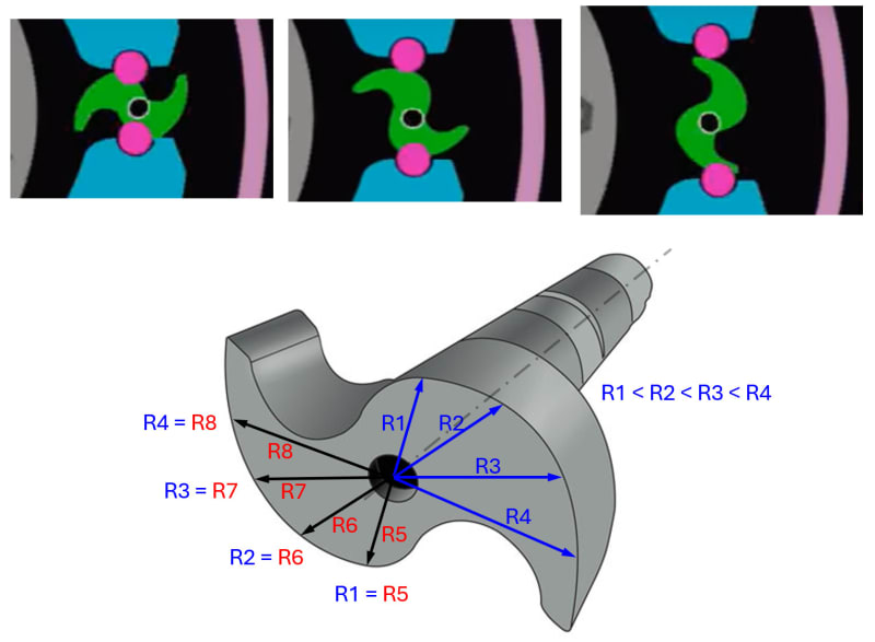

One place it is useful is in the likes of the s-cam used to operate air brakes on trucks. It is hugely important that the two cam surfaces match each other but not as important that they have an exact shape. Thanks for taking away the one control that can guarantee correct brake application without adding excess expense.

Could you, please, provide more details? Maybe even a simple drawing. What do you mean by "two cam surfaces match each other"?
I've seen this video (or maybe others alike), but not sure how would you control the S-cam with concentricity?
Which is the datum feature and which are the controlled features?
The axis is determined from the bearing for the s-camshaft. You control it by specifying it. Each pair of opposing points need a center within some distance of the axis. The cam surfaces should be concentric to the shaft axis.

But those two pairs of "C" shapes have different centers so how concentricity could be used? I know the "classical" examples of concentricity the entire feature has only one axis/ center (not two like the ""S" cam).
I am sure I am missing something.
Could you, please, show a sketch on how your proposal looks like?
Just trying to learn a little more.........
Read the definition - those "C" shapes usually have a spiral of constant angle of increase and are not an arc. The center points of opposed locations on the cam as the mutual line that passes through the axis is controlled.

1.) How concentricity suppose to work in this case? Do we need 4 concentricity callouts, one for each section with the same radii? (one concentricity for R1, another concentricty for R2, and so on and so forth)
Or a stand alone / single concentricity callout would be enough to clearly show the design intent?
2.) What would be the advantage of using concentricity versus profile in between points ? (considering the transitions between radii are to be marked with points). Or even composite profile between points with the lower segment refining the relationship between opposing features with the same nominal radii (R1 and R5; R2 and R6; etc.)
What concentricity brings to the table and profile / composite profile doesn't?
Do we really "care" about center points of those features (the cam surfaces) or we really "care" more about the cam surfaces itself?
Again, just trying to understand more what are we missing now that the concentricity is gone.

Profile controls the form. Concentricity doesn't. Concentricity is a refinement to other controls. ASME said that making the part with a more precise form than is required to get what concentricity provides is the only solution.
Why have position tolerance or angularity or runout or ... when making all surfaces with a profile of surface tolerance of 0.000001 would work just as well?
Whether one cares or not doesn't matter. What matters is whether concentricity is important to control a feature. ASME eliminated that control along with the planar version, symmetry.
