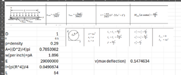

The deflection I calculate (screenshot below) for a 1" round, 5ft long at 54" datums (3" from either end), is a deflection of 0.147", so a significant amount and well out of tolerance to just ignore. That will be lessened slightly by the 3" cantilever on either end, but not near enough to counter the runout.
I'm using the 5' rod/1" round as a simple explanation. Real part is more complicated, with profiles, more end sticking out, etc. The calculated values (treating the smallest portion of the shaft as the rod) are within 20% of the as-measured.

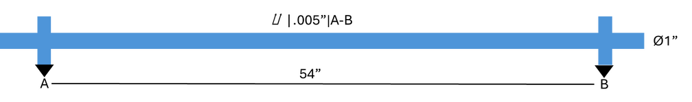

The datums are called out as the bearing journals. A mockup below. License server is acting up this morning, so, a master of powerpoint I am.
Since the datum line between two features is established by the vee-blocks, I don't think I can support the center of the shaft without over constraining the part. E.g; If I add a steady rest, I can make any bent part straight.

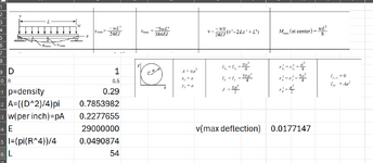

Also, note that there is an error in the calculation - W = rho * A; since rho and A are both less than 1, the product cannot exceed 1.
I calculated W = 0.227765467 lbf and vmax = -0.0177147 inches, still triple the allowable total runout.

You're completely right on the W calculation. It wasn't setup as a formula! (Value matched actual part, not the 1" rod we're discussing.) Corrected it and my value matches yours. See below. Thanks for the catch.
