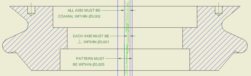

Thanks for the help. It got me farther in my thinking. I was able to make a dummy part that has similar feature than mine. It is a tube-like shape. The outter surface is not usable as a datum (not machined, casted). The goal is to constraint coaxially three portion of the inner cylinder (the 10, 8 and 9 diameters). The coaxiallity and perpendicularity must be tight, while the position of the whole can be slack (see first picture). I'm also trying to minimize the measuring error when quality control will check it (as one axis will be far away from the initial datum A), while keeping the design intent.
Design intent

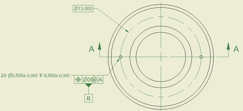

Top View (I am not certain about datum B if having a 0 MMC is the right choice...)

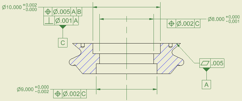

Idea
Here I was thinking of getting the first hole as a datum C and then getting a position of both second and third hole in regards to that datum C. However, I think doing it this way would mean in fact having the purple cylinder (in the design intent) parallel to the green cylinder. Am I correct on this interpretation? If so, it isn't my design intent.

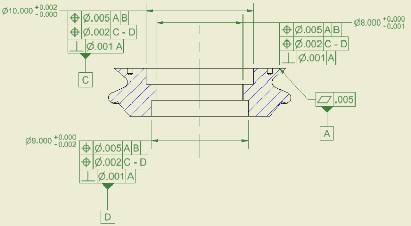

Idea 2
Here I think I capture the design intent. But I am not sure if I did something "illegal" according to Y14.5-2018 or should have used composite segment instead of single segment for the position. As I said, I'm far from being expert level.
Regards!
There is nothing illegal at any of the two ideas but idea no. 1 doesn't reflect the requirement that each axis must be perpendicular to A within .001" (that you stated in the first image). Only 1 of the 3 feature axes is controlled for that - the unrelated actual mating envelope axis of datum feature C.
