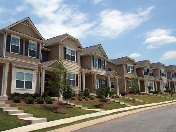

Forensic - I'm just going by the OP's description of the situation - obviously I'm not there to observe but he statement was definitive that "this one deck is one of 200 identical decks in this neighborhood.".
If there were 200 houses of very similar (identical?) design - I'd doubt that 200 different contractors built them individually - my guess would be that at least one other - and perhaps up to 2/3 may have been constructed by the same general contractor using the same details and same crews.
Similar to this kind of thing:
You are correct that we can't assert that they are all identical. But I would assert that there is a high probability that some of the 200 are identical.
If one deck collapsed then there is a high probability that others (between one other and perhaps up to 50 or more) might be in the same boat in terms of poor workmanship or design.
