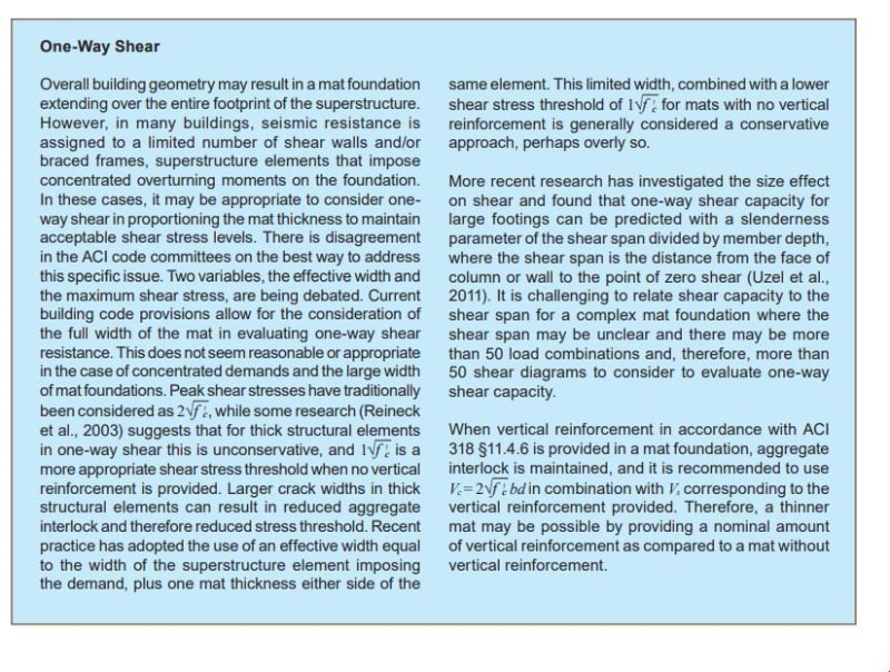

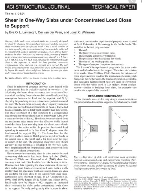

4) Both of the two documents shown below suggest that localized one-way shear is of some importance, albeit in somewhat different situations. The second one is NEHRP's guide on the seismic design of raft foundations.

The paper from ACI looks interesting, I was able to find it online but can only view the introduction (it is pay walled). They have conducted some test (big fan of this) and indicated in the introduction that there was a reduction in the mobilised effective width. I would be interested in what sort of failure they noted (if the whole slab hasn't shear, then this is likely a punching failure) and though there is a reduction in effective width there may be other factors that contributed to strength similar to punching shear behaviour.

Do you not find the NEHRP document blurb persuasive? They pretty much come right out and say that the full strip width should not be assumed to be mobilized for raft slabs. That one's a freebie: Link

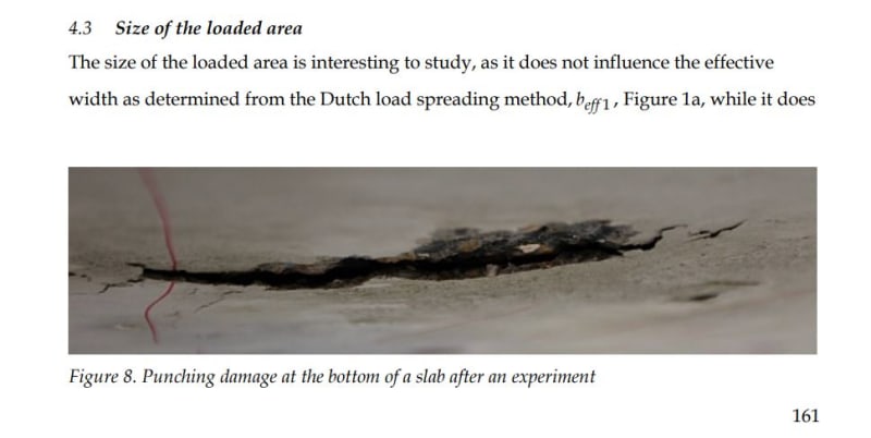

The dissertation that was the basis of the ACI paper can be had for free here: Link. And here: Link.

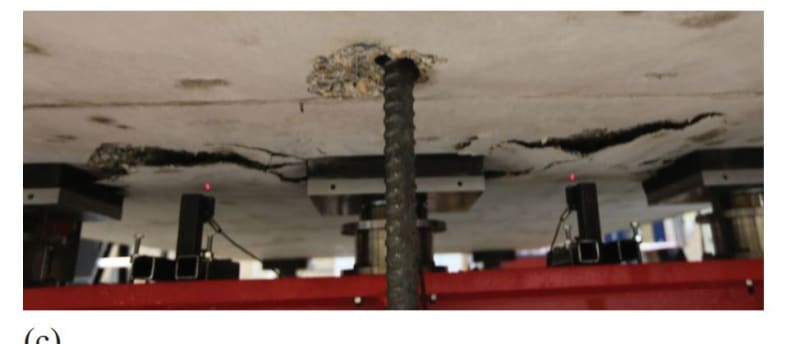

The types of damage observed are shown below and are characterized as one-way punching. One way and two way shear failure at concentrated loads are both "punching" after a fashion I believe.

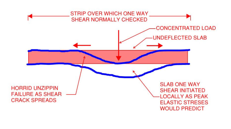

2) Either way, I believe that the rational fear is a local, non-ductile fracture followed by an unzipping that may well compromise the entire slab width. I've shown this conceptually in the first sketch below.
