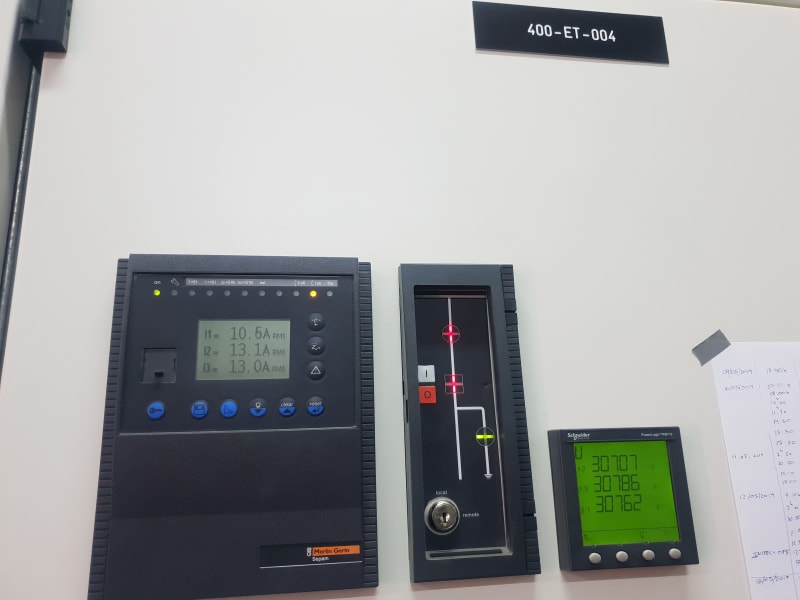

We have a distribution transformer 30/0.4kV 1.6MVA, which has the primary currents unbalanced. Secondary currents looks balanced +/- 80A. The transformer supply to MCC which has motor an single phase loads.
We've made insulation test 5000V 1 min, on primary side and the results are GOhms.
What can be the reason?
See attached picture.
Regards
What does the primary voltage balance look like?
Primary voltage looks balance. See Attached Picture.
Yesterday we've measured the secondary currents and we had: L1 1065A, L2 1015A, L3 1008A.
Transformer is 30kV Delta 400V Star, neutral solidly grounded.

The feeder has two sets of CT, one goes to protection relay SEPAM, and the other one goes to the Power meter. Both give us similar values for the unbalanced currents.
The unbalance seems to be around 2-3A, but when the demanded load increase the difference between phase L1 to the others increase to 3-4A.

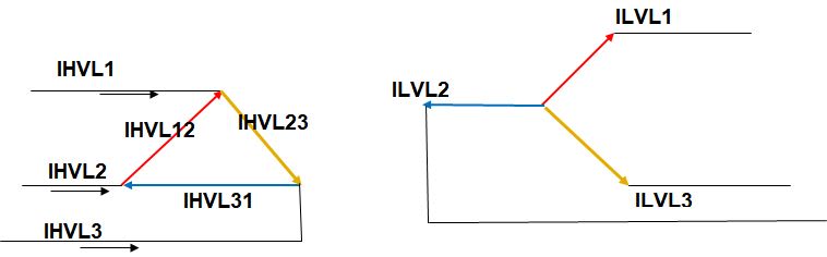

You could get this unbalance by having different phase angles on the secondary, even if the magnitudes were nearly balanced. This could come about be having some Ø-N loads and some Ø-Ø loads.
For example, with secondary currents of Ia = 1000A @ 0°, Ib = 1000A @ -100°, Ic = 1000A @ 120°, you would get IA = 11.79A @ 40°, 14.47A @ -80°, IC = 13.33A @ 150° in the primary. This assumes a 30/0.4 voltage ratio and no voltage drop.
You might be able to get phase angle measurements from either the relay or the panel meter.

Well, the relay seems that start detecting I0 current from 4A, (10% of primary CT 50/1), because when the load increase the I0 start detection immediately from 4, and increases little by little acc to the demanded load. For example with primary currents L1=10.8, L2= 13.7, L3=13.2 the relay I0=0, but when the demande load increases to L1=11.5 L2=14.5 L3=14.0 the I0=4A. So far the maximum value we've got is L1=14.3, L2= 18.3 L3= 17.3, then I0=4.9A. The relay is a SEPAM T20, so quite basic model of SEPAM and it doesn't have the phasors monitoring when we connect the laptop.

Like jghrist I calculated the HV current form LV-at first the transformer HV winding currents-and then the line currents. The windings ratio whv/wlv=30/(0.4/sqrt(3)=129.9.If we shall take the data from the post of 19 May 13:12 where the low voltage currents are mentioned and considering HV currents as per o.p. then the LV currents are-
considering L1 low voltage as 0 [reference]:
ILVL1=979.8-417.4i cosfi =0.92 [absolute 1065]
ILVL2=-926.6-414.4i cosfi=0.81 [absolute 1015]
ILVL3=372.4+936.7i cosfi=0.62 [absolute 1008]
Here is- indeed- a neutral current of 438.4 A [as sum of above currents].
Now, referring to HV and adding 0.34 A for each primary winding as no-load current[1.1% of rated] I calculated HV winding currents:
IHVL1L2=7.54-2.76i
IHVL2L3=-7.13-2.74i
IHVL3L1=2.87+7.66i
and now considering IHVL1=IHVL3L1-IHVL1L2
IHVL2=IHVL1L2-IHVL2L3
IHVL3=IHVL2L3-IHVL3L1 we get:
IHVL1=-4.68+10.42i and abs.value 11.42
IHVL2=14.68-0.023i and abs.value =14.67
IHVL3=-10-10.4i and abs.value=14.43
The sum of these currents is 0- as logic.
If we increase the current with 25%-keeping the cosfi constant- we get:
14.3;18.3;18 [close to data from 21 May 19:05 post.and Io[low voltage] will be 548 A
