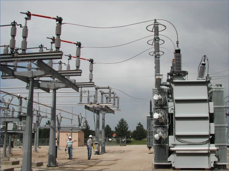

What fuse size is typically selected for transformers installed without fans? 100%, 125%, 133% or 167% of the primary FLA ONAN rating?
The sizes I have in mind are between 5/7.5MVA to 30/40/50MVA.
When a unit of this size is energized from a cold start how long can it remain overload above its ONAN rating? How long can these units sustain 133% of 167% loading without fans?

I'm seeing duration limits if 2x loading for 1,800 seconds, 3x for for 300 seconds, 4.75x for 60 seconds, 6.3x for 30 seconds, 11.3x for 10 seconds and 25x for 2 seconds based on page 8 of 13 and 9 of 14 in this pdf:
My thought process regarding my scheme-
A 30/40/50MVA transformer (just as an example) has an ONAN FLA of 150 amps. 133% of 150 is 200 amps, so a 200 amp SMD-2B fuse to allow for inrush and secondary side device coordination. Clearing times for bus faults that do not result in trafo damage.
According to page 4 of this PDF a 200E 115kv fuse can carry 258 amps continuously:
258x115x1.73=51.38 MVA, or 50MVA.
I'm thinking that under cold load restorations conditions, particularly where electric heat customers are in present on the feeders, I could load the unit to 50MVA for 1 hour.
Voltage drop without feeder regs or LTC would be fierce but it is doable in theory.
