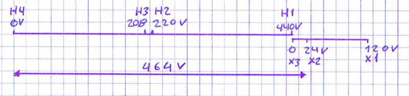

Sorry to come so late to this thread. But I do not see the problem at all.
I would connect H4 to phase A, then connect H3 to phase B. That will result in 440 V between H4 and H1. Then connect H1 and X3 to add 24 V so you get 464 V between H4 and X2. That is as close what you want as one can hope for - isn't it?
If you then do the same thing with the other two transformers, I think you will get the same result there.

Sorry again. I just realized that there is a problem with that connection. Never mind - Just forget.

Hahaha, thanks for the try Gunnar. You're making the same mistake I did on my first cut. If you look at one transformer and get it to put out 460, or there-a-bouts, when you subsequently go across those single transformer 460 terminals between transformers you get ~600V.
Also, if you'd actually read further you'd see these transformers actually have 0-208-230-460 taps unlike the ad-copy pap I initially believed and posted in my OP.

Step 1: Take one transformer and connect the available 230 Volts to the 230 Volt tap.
Step 2: Now you should have near 460 Volts on the 460 Volt tap. Use a resistor and see if you can load that tap (460 Volt) up to 100 VA.
Step 3: If you can load the transformer to 100 VA then the windings are arranged to our advantage.
Step 4: Take a second transformer and connect both H4 terminals to A phase. Depending on the voltage available connect either 208 Volts or 230 Volts to the appropriate tap. One transformer to B phase and the other to C phase.
Now you will have 460 Volts from H4 to H1 on each transformer and 460 Volts from H1 to H1.

The open delta autotransformer boost circuit that I suggest is a well known and frequently used connection in Canada.
The other question, Current rating. The 460 Volt tap will support the full 100 VA or 0.217 Amps. It will supply 0.217 Amps to your fan.
There is one winding connected to the winding. The motor current will flow in the transformer winding. No need to worry about phase angles and/or root 3.
The 208 Volt tap will support 100 VA. That is 0.418 amps. Chances are good that in that small a transformer it was more economical to wind the primary with one gauge of wire rather than taking the labour to stop and make a splice and change wire size.
If you pass step 3 you should be good to go.

If the full H winding is 460V and the full X winding is 120V, why worry about autotransformer connections instead of just going with a wye-delta? It would have to be fed from a 208V source though and not a 240V source.

My experiment is not to show the rating. It is to show whether the windings are arranged in such a way as to allow the primary winding to be used as a step-up auto-transformer.
As for the ratings: Yes, I know that transformers will withstand overloads. Using the VA / Volts gives the maximum rated current. The actual safe current may be somewhat higher. AS to PU overloads, A small control transformer may not be able to dissipate the heat as well as a distribution transformer. I expected Keith to make a judgement call as to how much overload he was prepared to push through the transformer.
