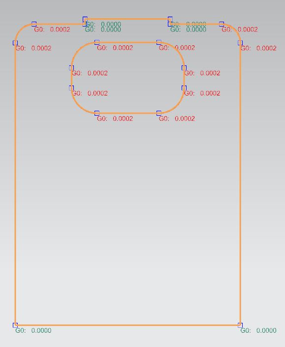

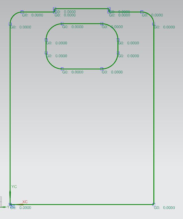

I am suffering from annoying translating behavior.
I need to export several closed profiles for import in a "wiring cutting application".
In NX, my curve profile is completely closed: I can to extrude, and the continuity G00 is perfect. If I export the profile in dxf, the "wiring cutting application" says that there is a GAP. Then if I import this dxf profile in NX, the profile now is opened (about 0,00014 mm.)!!
Is there a posibility to play with the tolerances to avoid this behavior?
Thanks in advance
Javier

No, there is no splines, only lines and arcs. The modeling tolerance in NX is the default 0.01 mm. I´ve played with this tolerance but it seem to be unrelated.
Regards,
Javier
I attached two images showing the continuity analisis after and before the translation.

What occurs to me is that there is a limit to the accuracy of the floating point representation in the DXF file which is being exposed by the arcs - each arc has 5 dimensions: the X and Y location of the center, the R(adius), and the Start and End angles. They typically do not include the exact X and Y coordinates of the end points. So in that stack of dimensions to get each endpoint if the DXF file doesn't have enough digits to represent those values when it gets read back in they will be the truncated values.

What version of NX are you using? Also, what is the largest dimension of your profile (vertical dimension top to bottom)? I ran a quick test in NX 1992; I made a rectangle with rounded corners in a sketch and exported it to DXF. Importing this to a new file and the continuity was OK in both files. Maybe it has to do with DXF export/import options?

Curve continuity reports G0: 0.0000 for all curve connections.

Hi cowsky thanks for your support.
With the option Export 3D I also get correct continuity, but unfortunately we need the options Export 2D and Export Selected View: "VISTA_CORTE" because we design in context and there are a lot of parts whose geometry orientation do not match the Absolute Csys. The wire-cutting application only accepts closed profiles on X-Y Plane from Absolute Csys.

Are you using the 2D exchange translator and NOT the DXF/DWG Translator ?!?
If yes, I think I know where you get the gaps from.
The 2D Exchange will flatten whatever you are looking by doing a CGM export to a temporary file, create a temporary part file and import the CGM and finally export the temporary part into the selected output Iges/ DXF/DWG.
The intermediate CGM should be the reason for the gaps. The CGM format was designed to be fast and simple not ultra precise.

I've done some test with CGM as intermediary, and you both (Toost and cowsky) are right: using cgm eliminates the problem with the gaps, but is also true that the result is not accurate enough.
Another work-around would be to create an assembly with the piece, reposition the component to Absolute Csys, and extract the curves on the assembly file, then export as dxf...I will try tomorrow.

Please check the attached DXF to see if it meets your needs. It was made by switching to drafting, creating a 1:1 view of your curves, exporting CGM, importing to new NX file, and exporting to DXF.
www.nxjournaling.com
Hi cowsky,
Yes, it meets. I have tried with several parts and the continuity is OK and the deviation is totally acceptable. It's a bit laborious but it does the job.
Thanks. Once again I have found a solution in this forum.[bigsmile]
