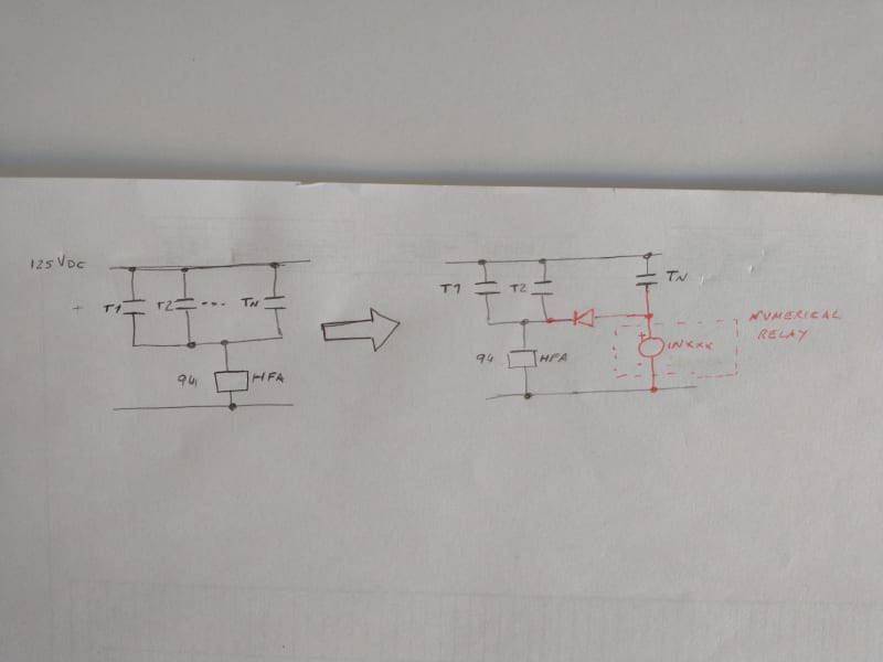

What we are trying to achieve in our case is to segregate a trip branch so that we can monitor it.
I think the sketch will clarify more than my words:
What we are trying to do is to "Monitor" the operation of Tripping Contact "N" (using a numerical IED input), which is connected in parallel with a number of other tripping contacts.
I suppose the rating of the diode will have to do much with the inductive kick and surges you were mentioning but
its purpose being to isolate our branch from them not directly to control or reduce them.
In your experience, should we go for a >1000V reverse voltage diode? Is there any type or manufacturer(s) normally used for this type of application?
Thank you again
If we did something like that, and we have at times, is use an E-max tripping diode.
Not just because of the ratings, but also as a device it is easer to mount on a control panel.
Loose small components are a pain to mount on a power system control panel.
Don't get me wrong, there are other options, but this is the quickest solution that I can come up with.
On a 48VDC system, we use "routing" diodes in this manner. Our specs call for 200V, 3A.
Just make sure you get the diode in going the right direction. Once had a bus lockout that used routing diodes to get to each breaker when the lockout tripped. One diode was backward. Fortunately, when the bus lockout was tripped for a fault, the remote end of the line with the backward diode overreached and transfer tripped the breaker the bus lockout couldn't.
