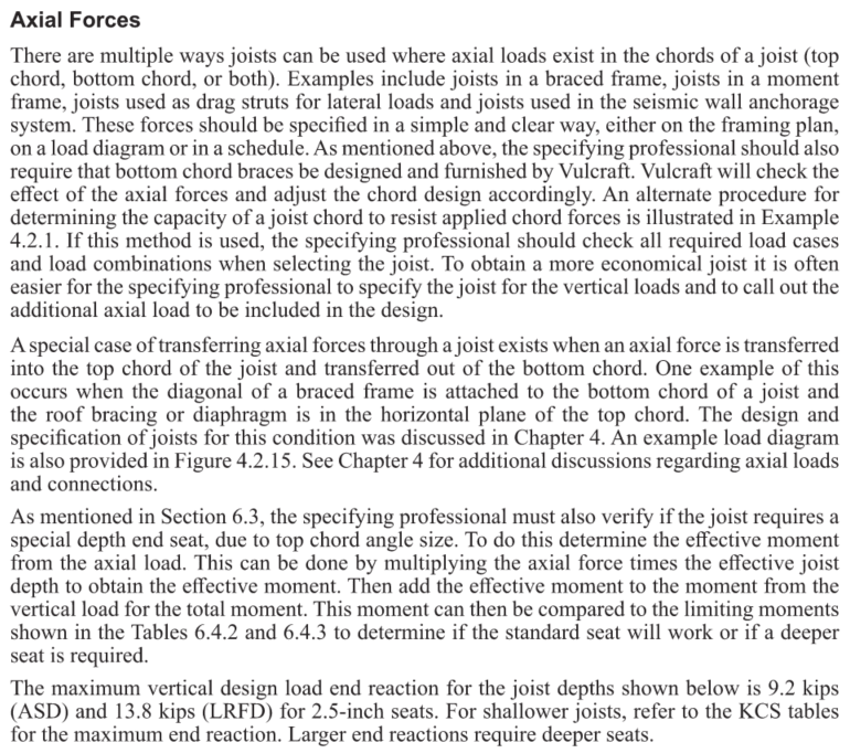

Here is some reading for this type of scenario in regards to open web steel joists.
Jump to Section '5.13 Diaphragms and Collectors'
Some text taken from this book:

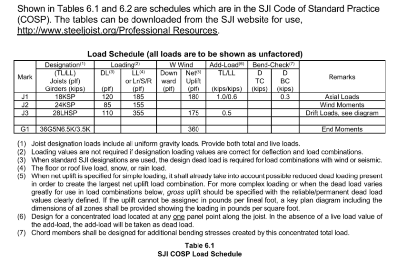

Example table for specifying loads from the Steel Joist Institute:

When I do this for OWSJ, I'll typically follow the format of the table I provided above with the addition of another column for wind axial load.
