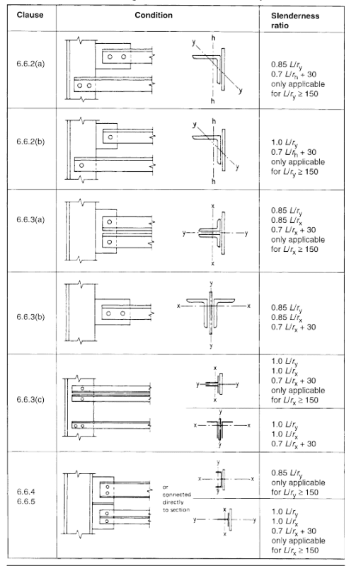

In my mind the OP's initial issue is usually dealt with as follows in this part of the world:-
For welded connection, align centerline noding based on centroids of angles about that axis/leg. If you cannot node all the angles (verticals/diagonals/chords), then model as per Kootk's advice and deal with the resulting design actions on the chords (and web members).
For bolted connections, align centerlines based on angle gauges/bolt group centerlines. Usually for angles in this part of the world (New Zealand), codes modify the slenderness based on the end connection type (see example below). Therefore design of angles directly takes account of the eccentricities involved between the bolt gauge and the centroids, if judged stocky (slenderness less than 150) then we are required to look at the moment and axial interaction for the design of the angles, so offset from bolt gauge to centroid of angle is directly accounted for by the moment induced by this condition. If slenderness is greater than 150 then the modified slenderness is meant to account directly for the effects of moment and axial load. Again if there are eccentricities in the noding of members though, then model appropriately to deal with actions resulting from eccentricities on the chords (and web members).
I suspect most standards have similar provisions to deal with these effects. I believe our provisions were originally based on British standards approach. Though I know that Australia who have an almost identical steel standard to New Zealand do not have these same more comprehensive provisions. Your mileage might vary then depending on code. But either way there should be provisions for combined bending/compression & bending/tension that you can apply provided you get a handle on the design actions resulting from the eccentricities involved.
Often small eccentricities lead to small moments, but often around the minor axis of member where capacity is equally proportionally low. So while you could potentially argue them away as being insignificant and small this is often not the case. For example a small minor axis 10kNm moment due to eccentricities, may well use up 10-20% of an I-section members capacity when you back calculate through all the combined actions checks. This is significant and should always be considered in my opinion.
