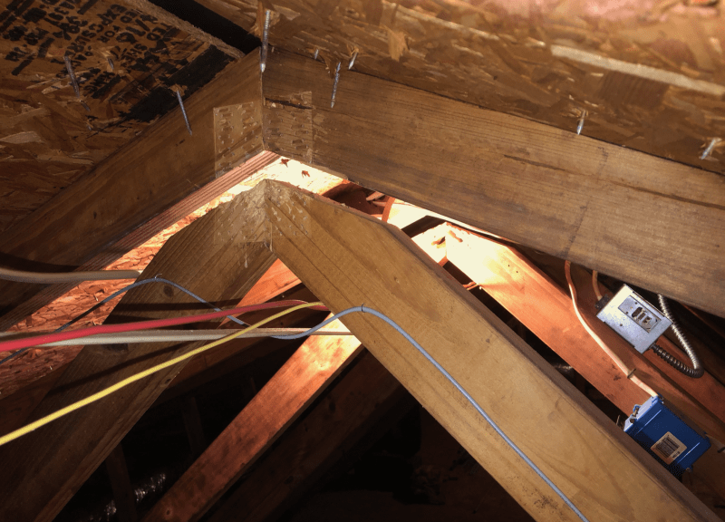

This guy thought it was a good idea to store a bunch of angle iron in his attic. Happened to every truss.

I’m not too impressed by those truss plates. Looks like they were attached with some (inadequate) glue.
No glue - they are pressed on nail plates - like most trusses.
Doesn't look like they pressed hard enough then....
Has the plate come off intact or have all the "nails" sheared off?
I haven't seen them but is my understanding that the plates just peeled off
Looks like pressed plate not nailed plate. And yeah, storing a bunch of steel in your attic is likely to overload those plates. The tabs are small enough that they'd definitely pull out before they sheared/ripped off the plate.

Was there any evidence of differential movement in shear? between the roof structure and the attic floor. That scrabbled tearing on the top surface looks quite odd, as though the plate sprung from the bottom surface before finally giving way / springing off. Guess we won't know what happened once the first one went
So did the bottom chord fail? Pretty crazy if it was still supporting the load in the attic. Maybe interior non load bearing wall came to the rescue.

When truss plates are overloaded they typically curl and pull out. I've never seen one come out as cleanly as that one. Usually they pull some chunks of wood out with them.

Old truss plates were a lot smaller than they are now. I cringe when I go up into the attic of my 70's vintage house.
Ron - look at the truss in the background. Looks like there are some chunks missing there.

One thing that you won't know for sure is how much deflection occurred with the walls on either side of the trusses since the roof load is no longer directed fully downward by the trusses. This could mean that jacking the up trusses wouldn't necessarily restore everything to the as-built configuration.
