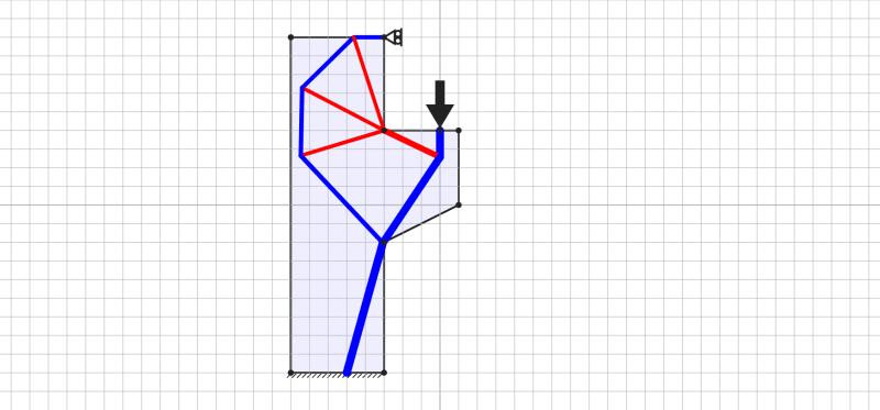

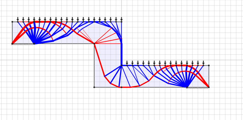

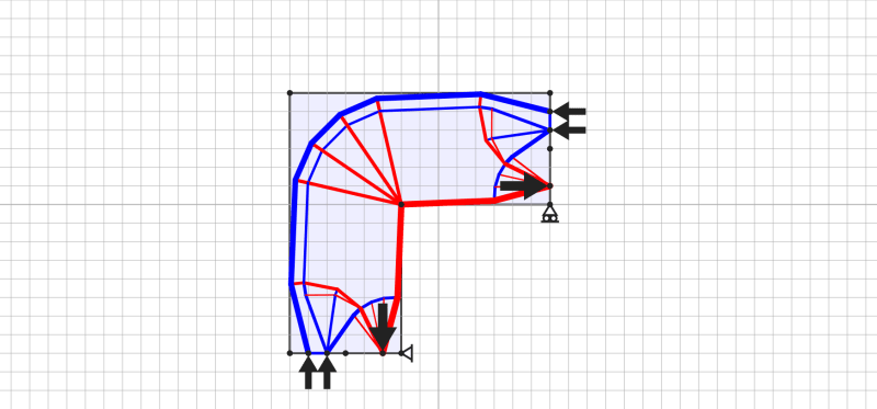

Thought I would share this neat, little LayOpt app that is based upon the Grasshopper plugin Peregrine.
You can load heaps of different examples including the Mitchell truss. Set other boundary conditions, loads and optimisation constraints.
This layout optimisation was used recently for a transfer truss on a hotel project in London.

How does it work? Does it consider buckling failure of compression elements when determining efficiency, or just assume some yield strength of material and only consider yield failure?

Canwesteng - I believe the proper Peregrine app and their other software does consider Euler buckling. However this web app seems to be stress limit based.
MIStructE_IRE - They are focusing on this using their simplication/rationalisation routines. From what I understand that hotel example did come out to be cheaper overall. Link to original IStructE article here.
