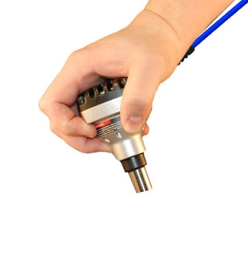

KootK, all good points that you make. One bit of feedback from a recent project regarding the difficulty of installation in a tight, dark, hard to reach area... it is a challenge for sure, but contractors on my project had success by pre-drilling lead holes in the plywood gusset and using a pneumatic palm nailer (instead of a regular nail gun or hammer). The palm nailer can fit into tight spaces and the pre-drilled lead holes acted as a guide to set the point of the nail in (blindly by feel if necessary).

Thanks, yours too. And I agree that the process you've described instills more confidence that I'd have in my typical, local, residential construction crew. I'm going to challenge you a little more on this though because, well, that's just what I do. The pic below shows the lowest profile hand nailer that Google was able to show me in 30 sec or less. Even at that, I contend that any nail going into a sheathed top chord is likely to be oriented at 30 degrees to the horizontal, at best. I think I'd prefer to see screws installed by hand, at least until some penetration is achieved.
KootK, You are probably right about not being able to drive nails into the top chord horizontally with the palm nailer. If I ever face this situation again, hopefully I will remember this. Maybe a trial mockup out in the garage is called for... when I get the time :)
