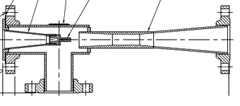

Here's a drawing of the exhauster itself. The bottom flange is what I blanked off measured the vacuum in a separate test run. The air compressor line was input on the left side flange connection.
What is not shown is the length of pipe used during our R&D tests that connects to the bottom flange that then goes down through the roof of our furnace. The flow through this pipe is what I need to calculate. Air is input from the left and exits out the right. Furnace air is pulled from below and also exits right.

I posted my reply before I saw your post with the sketch of the exhauster. There does not appear to be any additional restriction at the inlet. It is not really a venturi but more like an eductor with different pressure/flow characteristics than a venturi, although I am not that familiar with it. An eductor I believe more pulls/educts the air into the flowstream by the jet velocity action so flow is not strictly proportional to pressure in nozzle chamber.

I apologize if I've misled anyone with wrong terminology. After seeing the drawing, does that change anything with the calculations you've given?
More correctly what you have appears to be an "air ejector". I believe that the pressure you measured with flange blinded would result in measurement of the maximum suction pressure in the jet chamber during no flow in the suction, however there is an additional pressure drop when there is flow across the chamber entrance. If you measure a pressure with flange blinded at no flow the pressure at the same point during flow will be higher since there is an additional pressure drop/flow restriction to get the flow into the chamber flow area from the inlet flange connection. I am not that familiar with air ejectors though but I would just go by the manufacturer's flow curves.

Sizing an air ejector is very complicated as only Bernaulli and friction equations are not enough. Here are some of the additional complexities.
1. The suction air and motive air mixes in the nozzle chamber. This mixing may introduce significant energy loss(even though momentum is conserved)
2. The diffuser at the exit will introduce the maximum loss, which can be estimated from empirical fluid dynamic equations.
3. Friction losses at walls which are already discussed above.
4. The flow at nozzle exit (sometimes at diffuser exit too) is expected to be supersonic, introducing complexities like shock waves and connected losses.
The air ejector design is a specialized field and involves lot of labor. So you may discuss this with some air ejector designer and manufacturer.
I did not pick up that the vacuum of 3"Hg was measured at zero suction flow with the inlet blanked off. I feel a bit better seeing that Snickster also missed it initially but when my earlier calculation fell so far off the curve I should have been more suspicious.
Anyway, we are now in a position to make a much better estimate. The problem is basically the same as when you want to determine the operating point for a centrifugal pump and you have to find the point where the pump curve and the system curve intersect. You have the pump curve that was issued by the supplier so we just have to generate the system curve.
I assume that the pump curve was generated by the supplier knowing that the suction gas was at 1300F. If not, then what follows will be somewhat in error but it will illustrate the procedure required.
If the pressure at the top of the 1.5" pipe (where it bolts onto the venturi) were 14.66 psia it would be the same as the pressure in the furnace and there would be zero flow. So we can plot the first point of the system curve at 14.66 psia and 0.0 lb/h flow. At a pressure of 14.5 psia we would have a differential pressure of 0.16 psi and this would give a flow of 200 lb/h. Similarly, a suction pressure of 14.0 psia would give a differential pressure of 0.66 psi and a flow of 410 lb/h.
I have plotted these points on the attached copy of your pump curve and jointed them with straight lines in red and found the intersection to be at about 320 lb/h. If you were more confident of all the inputs you could plot more points and create a curve but in view of all the other uncertainties the straight lines don't really detract from the accuracy.
