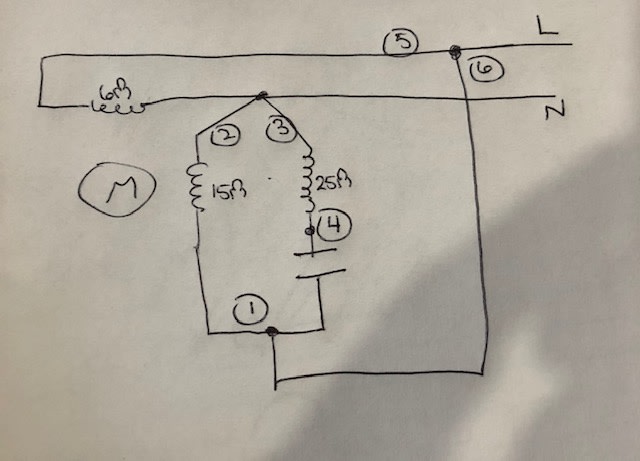

So, I have a 3 wire motor with capacitor which runs clockwise. I am trying to rewire it to run CCW. From what I understand, I need to flip the connections on the starter windings, which should make it run the other direction. However what I found when I opened up the motor is confusing me. I expected to find 2 coils (4 leads, starter and main coil), with the ends of both coils tied together on the neutral wire. What I found instead is 6 wires coming off of the coils (the wire sizes are similar, so its hard to figure which is which by eye). These are the wire details...

So from this I believe that BLK-WHT would be the starter windings. And BLU-WHT would be the main windings. RED-WHT confuses me
I disconnected the 6 wires and I am getting 15.2 ohms on 2 of the leads, and I get 6.1 ohms on another 2 of the leads. So that should be my starter and main coils.
With the last 2 leads I get 25.0 ohms
What I don't understand is why does it appear that there are 3 separate coils on the motor? I tried just flipping the two leads that go to the starter coil, but all the motor does is hum when it's energized. I feel like I'm missing something with the 3rd coil (if that's what I'm seeing) that the red capacitor lead goes to. This was the diagram that I was trying to use (colors indicated may be incorrect). top is what I thought the original config would be, bottom is to reverse the motor.
Could the capacitor leads be hooked up across a 3rd coil and my diagram is wrong? Can anyone point me in the right direction for what I'm trying to do?

It appears it was originally hooked up like this. any advice on which connection should move where? I numbered the ends of the coils as 1-6

Change #3 and #4.

By the way, your resistance values don't add up.
Your 6 Ohm reading is suspect.
That may be an overload device rather than a winding.
The 6 Ohm and the 15 Ohm windings should be equal resistance.
Maybe you got the motor because it had a problem developing.
Bill
"Why not the best?"
Jimmy Carter
Ah, must have messed something else up with it. I tried setting it back to the way it was and it won't spin clockwise either. Thanks for the help, probably just going to replace the thing and be done with it :)
