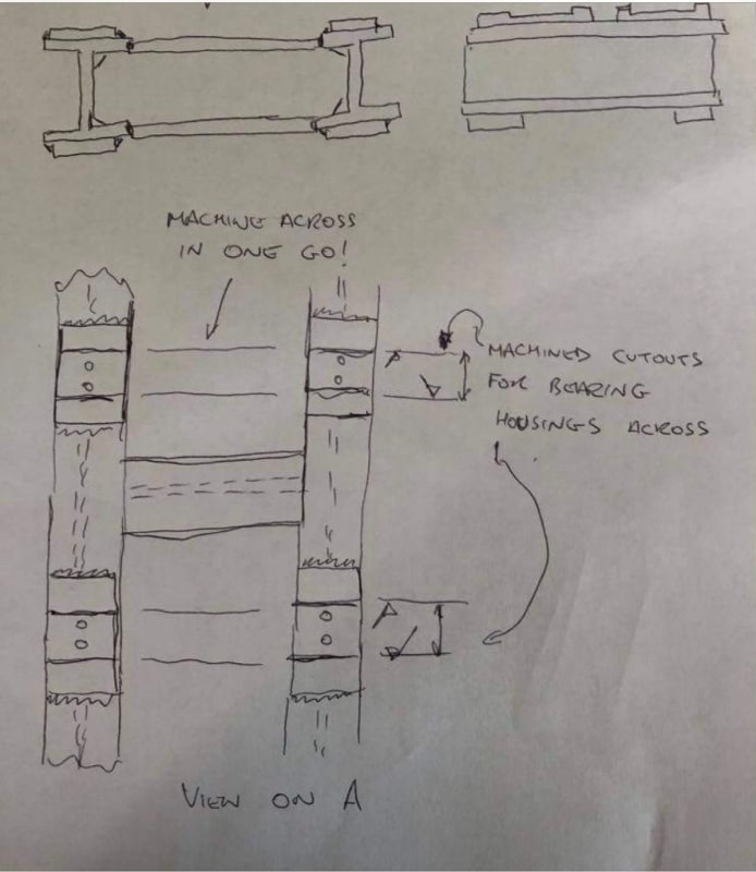

desertfox, you wrote:
we built the frames up and had bearing housing pockets machined on both sides of the frame simultaneously to ensure horizontal alignment
Could you elaborate more that? do you have some pictures or sketches?

Hi drodrig
See sketch, I have a 'I' beam right hand and left hand frame joined by an 'I' beam running horizontally across, plates are also welded to the top of the'I' beam and the whole thing is mounted in a machine and the welded plates on top of the 'I' beams are machined across in one go to ensure horizontal alignment.

We also used to machine the ends of the pillow block and make a machined fit with the pocket in the frame, so a tight clearance fit, the hole being oversized wouldn't matter then.

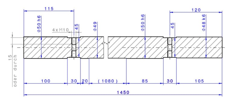

What about making a long bar (1450mm - 4.75 feet) sticking it in the gearbox and then position the bearings. Even with the block bearings
I have to check with our workshop if they able to produce such accurate rod. Maybe using different sections connected by dowel pins
I think a long shaft would work well for your application. There will be slop in the 3 shaft/bore interfaces and deflection of the bar. Those you can calculate to make sure alignment error is within acceptable limits.
