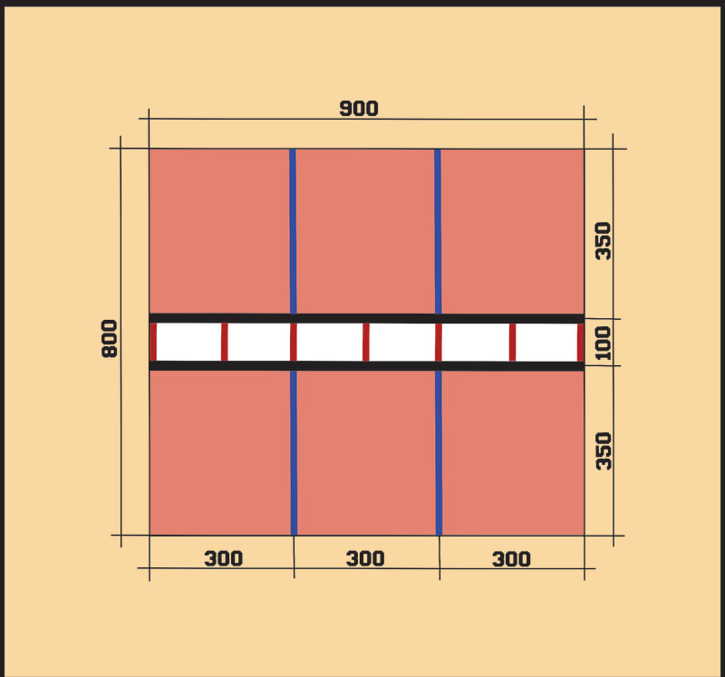

Can I assume (from the picture) that the unbraced length equals the distance between diaphragms?
Maybe... maybe not. It's a nuanced thing. Thankfully, there is Yura: Link.
Likely you can assume the unbraced length for the individual girders is the distance between the diaphragms.
The unbraced length for each pair of girders is an entirely different matter. That is likely equal to the span length, if it's a simple span, or possibly more for multiple spans, depending on the bracing condition at the interior piers.

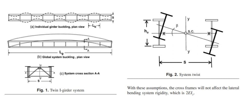

Interesting. The weak axis (single girder) becomes strong axis (two girders assembly), so the consideration of unbraced length changes as well.
In other terms, if you're particularly interested in checking lateral torsional buckling of a single girder, yes, you can assume that the unbraced length is equal to the distance between the diaphragms.
If checking lateral torsional buckling of the global system (prior to deck curing), no, it is a different ballgame. I suggest you navigate the link KootK provided and follow the solution provided there.

Look again the Fig. 1 in KtooK's graph - individual vs global.
BridgeSmith said:
It's actually only subject to LTB as a system if the girders are deep enough and close enough together that the vertical axis remains the strong axis of the system.
I don't believe that to be the case BridgeSmith. I agree that it would be if a longitudinal shear transfer mechanism existed to force the two girders to behave compositely. Here, however, such a mechanism does not exist. The clips shown below, from the Yura paper, show some examples of systems that are still prone to buckling with [composite Iy > 2 x Ix].
I envision the dual girder later torsional buckling problem as approximately [2 x single girder LTB + system warping resistance]. And in most practical cases, the latter term dominates.
It’s a simple house project, where the single I-beam in the middle of a spacious living room, became too high(deep), L= 30 feet. The investors insisted on reducing the I-beam size.
So I decided to use two I-beams with diaphragms every 3-4 feet, (because there was a „pressure“ to use as little steel as possible), instead of two separate beams. The diaphragms will be 10 to 20 inches long. I am not sure why the longer of the two (if so) is better.

10"? How tall are these beams? Just because the individual girders are LTB stabilized, that doesn't mean that LTB of the pair isn't still an issue. You can't just turn a blind eye to that piece of the puzzle.
Are you not able to brace the top flange of your beam to the floor or roof structure above? That's normally the case.

Regarding kootk's first post picture, you'll only get that higher mode of buckling between every diaphragm shown in (a) if the members are very stiff, forcing the higher mode of buckling is about stiffness. The other member is like a spring, make that spring stiff enough and you'll force a higher mode of buckling (this is quite easily demonstrated as per the blog posts I linked). Otherwise I'd imagine it will be more like both beams buckling together but in a constrained way provided the diaphragm adequately prevents the twist of the cross section. So as Klitor noted I'd expect the equivalent effective length is more likely to be over several diaphragm bays [EDIT... I'm talking here about the case before the bridge deck is in place to provide the final restraint].

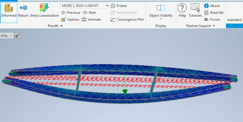

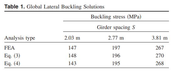

I did have a quick play with this behaviour. With I-beams, reasonable diaphragm spacing, and without the top restrain from a deck you need to have pretty long spans to get the the global LTB effect. But it can be teased out as the primary buckling mode. Though through my brief analysis it does seem an edge case scenario for your typical I-beam pair. That said, not considering very much lead to trouble eventually.
The Marcy Pedestrian Bridge is an interesting read there are a few online papers on it.
I’m not quite confident, that timber joists have enough bracing potential to restrain steel girders.

Am I on the safe side, if I skip buckling analysis and provide lateral restraints to the twin girder, doubling Lb. 2x1.5м=3м? (see the drawing)
If they're connected, they should be adequate bracing. It takes very little restraint to keep the beams straight, unless they are allowed to move significantly.
I'm seen research for bridges with steel beams and timber decks indicating that friction between the timber and steel due to a truck load on the bridge is adequate to brace the beams against LTB. I'm not suggesting that would be the case in your situation, just illustrating that it doesn't take a particularly strong connection to restrain LTB (as long as the beams remain relatively straight).
Maybe safe, maybe not. You need to do an appropriate buckling analysis to answer that question. Guessing is often wrong, and the reality is you'll never know you're wrong. What if it's 3x1.5m=4.5m and your design is right on the money at 3m....

For 2xHEA220, LTB doesn't seem to be dominant even without considering the floor restraint which would be significant.
You get full length buckling at Mcrit of 5x for 2 diaphragms (3m spacing) and 10x for 5 diaphragms (3m spacing).
Though as others have said you really should do this yourself. Don't rely on my rough and ready analysis.
