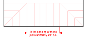

Seems like no mattery how I try to position the hip girder setbacks, something is always off. What is the more important here?
1. Provide a setback that doesn't interfere with your window openings (not always possible).
2. Provide the SAME setback for all sides of the building, so this allows for similar construction of the jack trusses? This causes the issues shown below.
3. Provide unique setbacks so that jack trusses maintain 24" o.c. spacing? Seems excessive.
4. Provide unique setbacks so your line of common trusses along the entire building length maintain 24"o.c. Seems like this would help out the roofers the most, but I'm not sure.
I'm trying to be more aware of the wood structural panel sheathing layout but it seems like something is always going to be off? This was a lot easier when I just used one setback and spaced trusses however I wanted.

Either way, here is what I was referring to.
3- Sorry, maybe the way I worded it. I'll usually use a hip jack. The location where the hip jack meets the girder will square off the run of field jacks along the hip end. Depending on the setback, that can alter the ability of ALL jacks to go in at 24" o.c.
4 - The idea here was setting the hip girder to meet the following.

I think in both of your drawings, wouldn't you tend to lay out the main sequence of trusses @ 24" o.c. and then place the various mono trusses and the hip trusses? so that 24" spacing bit in terms of layout is wagging the dog, if you would, and the placement of the girder truss is then somewhere at the end, 4', 6', 8' +/- (with the emphasis on the +/- there? That hip truss in this kind of situation would be 45° and if the little trusses get a bit off from 24" o.c. that's fine?

They may not, but in these environs, the main girder truss is spaced 8' from the outside wall stud. The space between is not a multiple of 2'.
I can only tell you what I do and what my thoughts are. There are so many different points of view and ways of building hip ends that I don't believe there is any one right answer.
We typically sell trusses to framers. And framers want the trusses all at 2' O.C. so the plywood goes down more easily. So that's the first priority.
Girders over windows are usually not an issue, as we're not dealing with large reactions. If we have something like a 40' wide house with a hip girder sitting over a 16' patio door - That's different. We pay attention to things like that.
Commercial buildings are a bit different. Longer spans mean higher reactions and more issues. Sometimes girder setbacks need to be longer on low sloped roofs in order to get enough depth in the hip girder so it works. Or doesn't have excessive deflection.
An example of what I most often do: Take a 23' hip system. Half the span is obviously 12'. Start with a common truss centered on the intersection of the ridge lines. So from the end of the building it's 12' to the center of the truss.
We typically build corner sets 8' or less. So there would be one step-down truss and then the hip girder. The setback to the hip girder would be 7' 11 1/4". That means the plywood would break all across the hip jacks.
As I said before, there are many ways of doing it. That's only one.
Based on experience, I'd say the most common setback I've seen is between 7 and 8'. If you're somewhere around that things are likely to work fine.

1.Where is your truss type A (1-11 1/4") being measured from? I ask this because the summation of dimensions across the width of the building is 23'-10 1/2". So the overall 24'-0" width is short by 1-1/2". I'm just trying to understand exactly how all the dimensions are accounted for.
2. Let's assume the building is 55'-0" in length. Using the value 55.0' - (2)1.9375' = 51'-1 1/2". How are 2ft o.c. trusses maintained with such an odd spacing? Where to you choose do make your adjustment (one set of trusses needs to be spaced 13 1/2" apart)?
The dimension of 1' 11 1/4" to the "A" jack is from the outside of framing to the face of the jack. Then 2' OC from there.
It's actually 24' 0" across the end. Where the dimensions meet in the center, that jack is 1.5" wide. If you look closely at the dimensions you'll see it.
I rarely try to line up trusses along the length of a building. Let's say there's a 24x30 building with the above hip at both ends. In theory the trusses would fall 2' OC. But in reality, framing is never perfect. The foundation maybe out a bit. The walls may be off a bit. They may lean in or out a hair. So somewhere along the line you end up with an odd space. I typically mark it as such on the layout.
