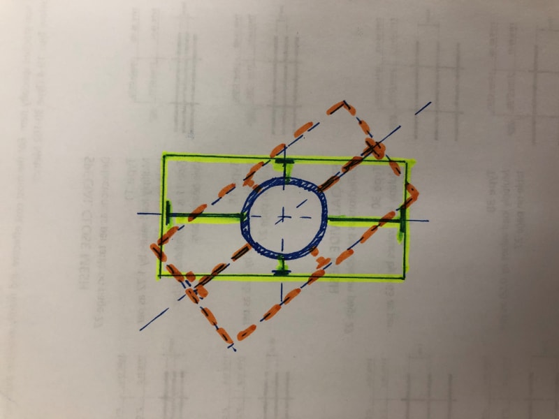

Dear Experts,
I rarely post in this forum, but we have a project that consists of twisting the above mentioned hollow tube for a 90 degrees.
I have read that people tend to heat the tube, or to put a pipe inside of it to prevent collapsing or even sand and to pressurize it a little and then to start twisting.
My problem is that we can't heat, or put a pipe inside (since its a rectangular shape) and the section is fairly large and requires a lot of torque applied.
Some people cut the four corner of the tube and then grind diagonally along each face of the tube and then twist and then weld the cut edges. but I'm not sure than I can do that sine it's an architectural project.
Any insights??

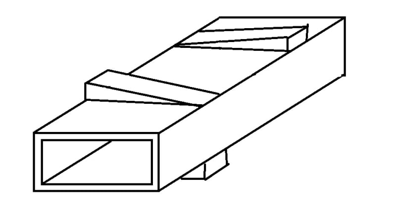

My idea is to put it in a press, with wedges under it and on top at one point, and wedges sloping the other way at another point just down from it. Press that assembly, slide it down, and repeat. You could vary the twist angle by varying the wedge slopes and by varying the spacing between the wedges. It's hard to visualize how the finished product would look. One advantage of that technique is you could try it on a short piece, and wouldn't have to screw up (<== note pun) a 40' piece testing how it worked. Hot forming would be an option.
You could cut rectangular plates and insert them in various ways to help hold the shape, if that was required. I'm not sure if sand would help there, as the shape could still skew (ie, shift from a rectangular cross-section to a rhombus cross-section). Putting rectangular plates in while forming, I'm not sure if they'd come back out or not.

If this isn't carrying any load aside from self weight, this might be an option:
Use a straight piece of tube or pipe with a series of brackets placed along length of the pipe to match the rotated section. Then you can use a thin skin plate fastened to the rotating brackets. If you cut the skin plates in the right shape (I don't think they would be simple rectangles) they should conform the brackets easily and with no bulging/buckling. I think this might end up being cheaper/easier and might give you more consistent results as well.
