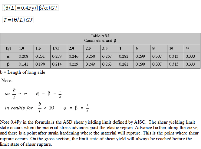

I rarely post in this forum, but we have a project that consists of twisting the above mentioned hollow tube for a 90 degrees.
I have read that people tend to heat the tube, or to put a pipe inside of it to prevent collapsing or even sand and to pressurize it a little and then to start twisting.
My problem is that we can't heat, or put a pipe inside (since its a rectangular shape) and the section is fairly large and requires a lot of torque applied.
Some people cut the four corner of the tube and then grind diagonally along each face of the tube and then twist and then weld the cut edges. but I'm not sure than I can do that sine it's an architectural project.
Any insights??

The formula may help in planning the process to avoid crashing the tube. It works the best with the incorporation of suggestions received from JStephen and CANPRO.

I believe your b/t ratio is too high to preclude buckling before reaching the torsional (shear) yielding you require.

I did some calculation and the amount of torque required to do this job is dramatically high. we will need to use the press instead (Option 1)
thank you!
