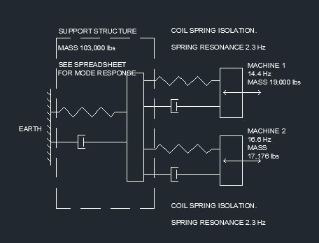

I have a structure with two vibrating screens (14.4 Hz and 16.6 Hz) they are on separate levels but share columns. We are having a lot of trouble with one screen but no one has been able to find vibration reading that show a problem. My question is how do the vibration forces combine from two different pieces of vibrating equipment? I have read about beat frequencies but that seemed very specific to audio frequencies. Plus (as I understand beat frequencies) it would be 16.6-14.4=2.2 Hz. When I do FFT from my field reading I don't see anything in this area. I am recording 59 seconds of data so it seems like I should collect several instances of a 2.2 Hz signal.
Is it possible the two signals could peak at the same time but infrequently? I am wondering if that is happening and sending a shock wave through the structure but it just hasn't been captured in recording data yet.
FFT's shows strongest reading at the machine vibrating frequency. So that gives me confidence my data collection and analysis is ok.
The machine supplier has said the structure is at fault but they haven't shared their data or said that some parameter is out of spec.

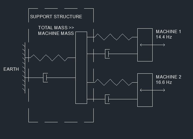

I made what I think s a correct model for the situation I am asking about. Also attached as PDF

(2B)+(2B)' ?
(a) I don't know of a mathematical reliable way to do envelope analysis. If you do RMS then the heterodyning vanishes.
(b) I've decided I don't really like that model
(c) it is two mass/spring SDOF blocks in parallel, sitting on top of a grounded sdof block. So it is the same architecture as Ideem drew. Due to a modelling assumption that is incorrect the results can only be correct if the mass of the thrid sdof block >> mass of the other two.

Sorry, I have been out of town a few days and just now getting back to my computer.
GregLocock, can you tell me what k,m c are? I can guess k is spring constant and m is mass but not sure what c is.
I have recorded acceleration data after machine 1 (where machine 1 attaches to the main structure), I would be happy to share the raw data if it is of use. I have used it to calculate velocities using Vibration Data Toolbox.
Prior to modifications I did a startup and shutdown to verify my model frequencies. They were in the ball park. The structure has since been modified and I haven't done any new shutdown tests.
Main issue is machine 1 springs keep failing. The equipment supplier doesn't provide any guidance on maximum support structure velocities (or any other dynamic acceptance criteria).
GregLocock
Here are the weights and some of the dynamic information added to the schematic.
A printout of all the structural frequencies is in the attached excel file.
Either this post or the next (if the file doesn't attach) are the velocities I measured on the machine 1 base at three different dates. The 10/20/2020 is before structural modifications.
Yeah, I don't understand your analyses. That doesn't matter. What excited the vibrating screens to cause the problem? do they both run off the same motor at some speed, or do they have independent motors that run at the resonant frequencies? or what?
Cheers
Greg Locock
There are two machines on a two level braced frame structure. Machine 1 is on the top level and machine 2 is on the second level.
The vibrating screens are for aggregate processing.
It looks a lot like the link below except there is another screen below the top screen.
The screen/machine is for sorting rocks into different sizes. It's basically multiple levels of big mesh screens that sit inside a frame that is supported on springs. A motor with eccentric weights spins around and causes the frame to vibrate at the frequencies in the diagram. The problem is springs on machine 1 keep breaking. I thought maybe the two machines running at the same time were creating a "new" vibration in the structure by superposition and that was close to a resonance in the structure which in turn was causing the springs to break.
Based on what I read in the thread superposition is not the right way to think about the problem.
Link
Beating, heterodyning, whatever, is always a confusing topic.
Given that the only coupling between the two lightweight screens is a five ton frame, conceptually it seems unlikely that screen1 is going to have much effect on screen2.
I'll have to rejig my model a bit, then I'll pull out the spring forces.
Cheers
Greg Locock
It seems like observation of the system would be most helpful. Fire up one of the shakers and see what it does and then fire up the second one and see if the first one responds any differently. Then shut off the first one and see if the second one responds any differently.
I don't think anyone objected to superposition (the response at any location is likely the sum of the individual responses you'd get from each machine running). It's just the idea that superposition creates a new frequency that was objected to.
