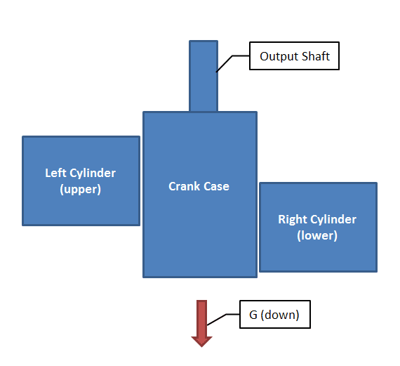

2. djhurayt, here is the scheme of the engine orientation:
The right cylinder is the lower one. The abnormal behaviour of the temperature as I see it is where frequent oscillations of the right cylinder (blue on the chart) present and reach too high values​
3. EHudson, Unfortunately I have no EGT measuring. Regarding the residual oil/fuel in the crankcase - good point! It seems that exactly the "problematic" cylinder is the lower one and may receive extra-portions of oil/fuel. What kind of problems this may lead to? How I can detect this and treat?

Crankcases loading up with fuel and oil are nothing new and lead to irregular running. When emissions regulations came around most chain saws went from horizontal cylinders to vertical cylinders in part minimize this fluctuation.
Explore the small check valves used on multi-cylinder outboards to purge pooled crankcase liquids and return them to the intake. These operate under extremely low pressure differentials and use the crankcase pressure pulses to operate them. Run a hose from the valve to the top of the reed block and let the reed action take care of dispersing the liquid back into the engine.
There may be a good spot for the check valve between the lower bearing and respective shaft seal or a low spot in the crankcase. Is one transfer port low and the other high?
The configuration of your engine will never allow thing to be perfect.
