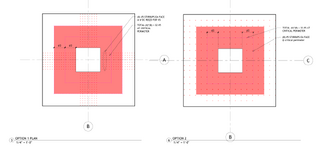

Recently I was working with some really large loads and trying to deal with punching shear on thick concrete elements.
I worked the ACI equations for punching shear and I needed (32) #5, bars, (8) legs*4 sides, at my critical perimeter, at a spacing of 6"oc.

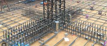

Traditional examples of punching shear reinforcing always show this thin flat slabs, typically using stud rails that are centered on the column width and then stay within the same column dimensions as they move away from the column.
I aimed to match this traditional layout in my heavily loaded thick foundation.
See option 1 below:
I showed this to a colleague and they asked to splay these out over the critical perimeter, which I initially thought would be fine, but now I have some concerns.
Option 2:
Option 2 has the same amount of reinforcing at the critical perimeter, 8 #5 per face, but the spacing can be greatly reduced, to around 1.25ft in each direction with this setup.
I think the code really is pushing for option 1 as is traditional with shear stud rail layout, but I wanted others opinions.

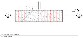

ACI 318-19 now works in shear stress for vs, but I think the heart of the equation is finding the # of bars that cross the d away failure plane as shown in the red region below:
Option 2 starts to make a come back in raw steel area after d/2 away into the d region, but I don't think it is enough typically. Also the stress concentrations are highest near the column support, so it feels a bit dubious to pick up extra capacity away from the column?

We've always done option 1. When SSR's get to heavy or require additional demand then we add drop panels. There's a reason it's called the critical zone. Curious what others who do more concrete design say.

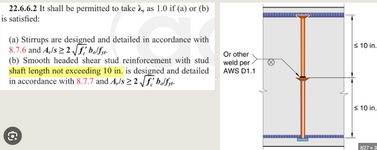

@bookowski Dropping this here for reference, studs greater than 10" need to be piggybacked, commentary suggest the head helps to anchor the taller stud
. 318-19 Table 22.6.6.1: vc is limited to 2sqrt(f'c) for stirrups and 3sqrt(f'c) for stud rails (generally - check the table for other cases). NOTE that almost all ICC-ESR reports for studrails that I have seen will override this value, limiting vc to 1.5sqrt(f'c) instead

Does option 1 and 2 create the same periphery failure surface? I'm familiar with the octagonish second critical section which seems more applicable to your option 1, which means the two options would have different perimeters - potentially requiring option 1 to extend further from the column to achieve the same punching capacity as option 2. Ballparking it would mean you would need to go 42% further to get the same perimeter area (each corner in this case would be L*sqrt(2) vs 2*L in the option 2 square corner case)
EDIT: I suppose the thicker the element gets, the closer that option 1 will get to becoming more and more squared out. So for a thick foundation element in your case, this is probably less important.
For arguments sake, let's say yes.
Technically if you continued the area reinforcing in all directions, option 2 would be even better.
I just want to focus on the first critical perimeter for now.
Got it - I'm with you. I think the logic is sound - since your d is so much larger, your failure cone gets big enough that if you are able to space the punching reinf further apart, I don't see an immediate red flag against it
