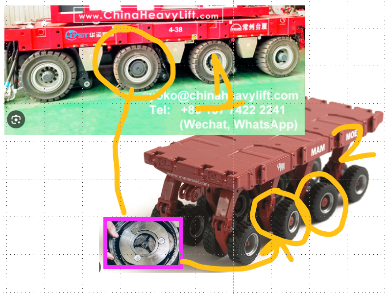

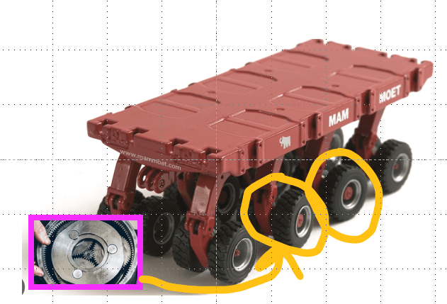

Attaching here a real picture of the equipment (maybe makes it easier for me to explain myself?).
Wheels surrounded by a yellow circle are driven wheels, they have inside them a driven engine, the gears are driven by oil being pumped at a certain pressure from an oil reservoir built-in.
This equipment has such amount of driven engines to transport massive load above their platform (15 times their self weight) when a lot of traction is needed to overcome steep slopes.
In flat surfaces, with low friction coeffcient, and the equipment being empty loaded we have seen you need to turn off half of the driven engines in order for the equipment to be able to move (linear motion, steering, whatever).. if you don't turn off half of them, wheels will start to spin in the same point, and the equipment is not able to move in linear motion.
Hope this is a better explanation.

That looks like a picture of a toy version, but this is the proper thing - an SPMT.

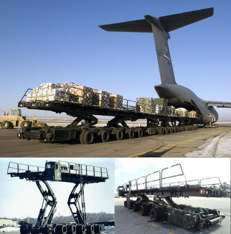

I was on the design team for this (not the planes):
On the OP vehicle, if the model matches, the suspension puts equal loads on connected cylinders - probably the OP vehicle ties each corner pair for stability. It means the load on the drive wheels is half the total load, acting effectively between the pairs. Since the load is distributed, the 4WD configuration sees only 1/2 the download and 2WD sees only 1/4th om the driving wheels.
Our vehicle beat the competition largely because a snowfall on the airbase used for testing had only one transport vehicle able to move on the slippery surface - ours - with 4 of 10 axles being powered. I don't recall the plumbing but I doubt they were simply in parallel, allowing one wheel to slip and stop it from moving would have spoiled it.

3DDave. No, not chinesse. The picture was just for reference. The equipment is german (Scheuerle/Nicolas/Kamag).
I will try to find the hydraulic schematics, but does it really make a difference to explain this situation? I mean, oil is pump through a pipe below the deck platform, and that pipe feeds all the driven engines at the same time.
How can you turn off one driven engine? Just closing a valve, so not more oil can be feed to that wheel. Each leg/bogie has their own set of valves. So by turning off one driven engine, you are not turning off the other ones.
As I said before, I've seen this situation several times, in different locations.. It's not related to something specific as somebody thought before when asking too many questions.
It is just like that.. this equipment is design with standard amount of driven engines, and double than standard driven engines. Why double? Sometimes you need more traction to transport heavier loads in steep slopes.. What is the downside? Well the situation I'm describing with just this single equipment.. When the 4 axles is empty loaded in a low coefficient friction surface, the driven wheels start to spin instead of pushing the trailer in linear motion, that means, the trailer does not move at all, in any direction.
So, is this a issue of TOO much torque, and few weight (thus friction), causing the wheels to spin instead of pushing forward (not enough traction)?
I'm just trying to find here the reasoning behind a situation we have seen several times, in several locations, with several trailers (same design).
The trailer/equipment is not broken.
