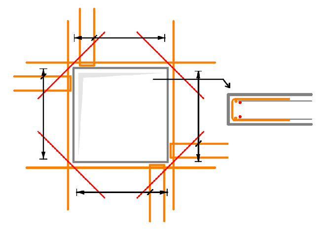

Typical detail for holes in 2-way flat slabs

Has anyone developed a good comprehensive typical detail for holes in two-way flat slabs that are not supported by beams or walls? It would deal with added diagonal corner bars to control slab cracking emanating from the corners, bars along sides of openings, max size of openings, etc. I have seen some typ details but they seem not very comprehensive.

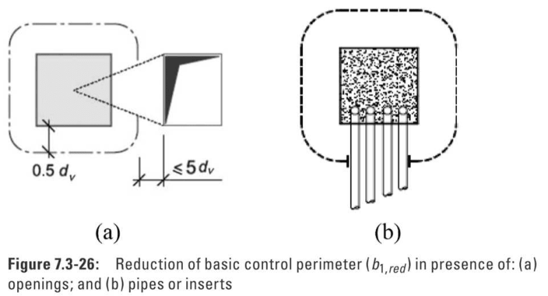

Also, does anyone have any rule of thumb about how far away from supporting column face, a hole though a two way flat plate or flat slab with drop panel should be so that it does not affect the punching shear stress?
Canadian Standard CSA A23.3-2014 clause 13.3.3.4 says, "When openings in slabs are located at a distance of less than 10 times the slab thickness from a concentrated load or reaction area, or when openings in slabs without beams are located within a column strip, that part of the perimeter of the critical shear section which is enclosed by straight lines projecting from the centre of the load or reaction area and tangent to the boundaries of the openings shall be considered ineffective." Most probably ACI 318 says the same, although I do not have it.
This means that for say an 8" slab and 4"drop (total= 12"), any hole closer than 10 feet away from the column support will affect the calculated shear stress. That does not seem reasonable. Any comment?

ACI says pretty much the same as CSA (10d).
Modelcode 2010, eurocode and swisscode says 5.5 to 6d distance from support face and has to be considered in the same way as CSA:
If you have a drop: The codes I mentioned define dv as the slab thickness without the drop, so in your example it would be resonable to take d = 8".
However always use your engineering judgement. For small openings (< 30cm)/pipes I would go with 5d distance to the controll perimeter and reduce the perimeter, no corner bars added at all, especially in case of circular openings.
For bigger rectancular openings i would arrange some stirrups and bars along the sides and diagonal bars in the corners as you mentioned. The same you would do in walls for a window. I consider them best practice for crack control and do not really calculate them. What do you find not comprehensive?

I have seen some discussion around diagonal bars at openings in concrete - particularly that they aren't needed, they don't provide any benefit, and in fact they are detrimental as they create a lot of bar congestion around the corners, which are sensitive to cracking.
the regular steel grid should suffice - if any more reinforcement is desired, run extra bars parallel to the opening
The Australian code says punching shear strength is reduced if the clear distance between the critical shear perimeter and the hole is less than 2.5*hole diameter (or hole width measured perpendicular to a line from hole to column).
The critical perimeter is half the average effective depth away from the column face.
to NorthCivil - thanks for that info. I too had thought of eliminating the diagonal bars and increasing the parallel to the side bars to compensate. But I seem to recall reading many years ago about research work that showed that diagonal bars were more effective in resisting corner cracking, than parallel bars. (I think it may have been in an ACI Journal. Can anyone else recall that?). I suppose it might depend on how much the parallel bars are increased. But adding corner bars is such a very common practice that I am reluctant to eliminate them because any corner cracking (which is probably inevitable no matter how it is reinforced) will be attributed to lack of corner bars and I don't know that I would want to try to defend that in court it it ever came to that. But I will give it further thought.

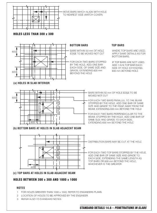

Here's the Australian detailing manual's page. The British manual is somewhat similar but calls for 45*diameter extension of the additional bars beyond the hole rather than 600mm. I think the larger of the two should be used. The Australian details are on one page so I've posted them out of convenience.
The British manual also recommends diagonal trimmers for slabs thicker than 250mm, area to be similar to the main reinforcement, subject to not causing congestion. My own view is that diagonals are good if they're in the surface layer, but if they're in the third layer from the surface they're obviously far less effective and just contributing to congestion. Trimmers in the main directions can do the same job but need twice the steel than diagonals. The area of trimmers should probably be related to the slab depth as the tensile force required to cause the crack is larger in a thicker slab.

Yes, that's what I meant but was thinking of the case of many bars at regular spacing. Say you have 10mm bars at 100mm centres in the x-direction, or 10 bars per metre. Cut a section at 45 degrees where a crack is forming. Over 1m of the 45 degree section, you have 7.07 bars (cos 45 degrees), with the maximum force perpendicular to the 45-degree section being (cos 45 degrees)*yield strength due to the bars being at an angle to the section. So the strength per unit length on the 45-degree section is (cos 45)^2 = 0.5* the x-direction strength. Repeat for the y-direction.
Trimmers however are a single bar (or a bundled pair acting like a single), so one of those (cos 45) doesn't apply. That calculation was for strength though. For crack control, maybe it gets reintroduced somehow for equal crack width; I haven't thought that through. It's not an exact science though. I'd just put about whatever diagonal trimmers you were thinking of in each of the x & y directions.
